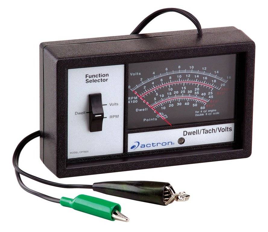

I got this to check against my very old one. They are cheap.

Since your reading of 58 degrees is ~double what the reading should be, I would say you are in the 4 cylinder range of your meter. Either you are reading it wrong, or there's a switch somewhere etc. Could be the meter is just bad too.
