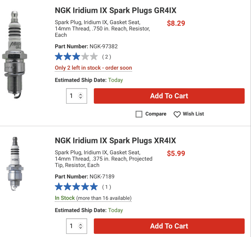

Forever is appealing. Are those the NGK Iridium plugs to which you are referring? (different reach for SB and BB)
Yep, something like that.
