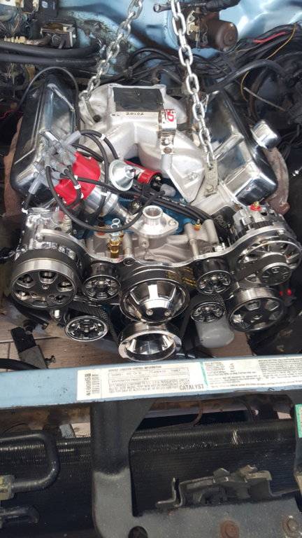

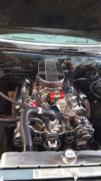

These are what I have had on mine for years now, it's been so long I can't remember if there were any issues but I don't think so.
Everything MSD. MSD Billet distributor, MSD 6AL Ignition box, MSD Blaster 2 Coil, MSD wires.
