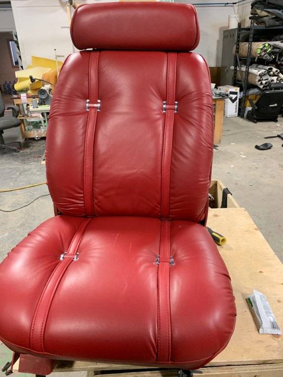

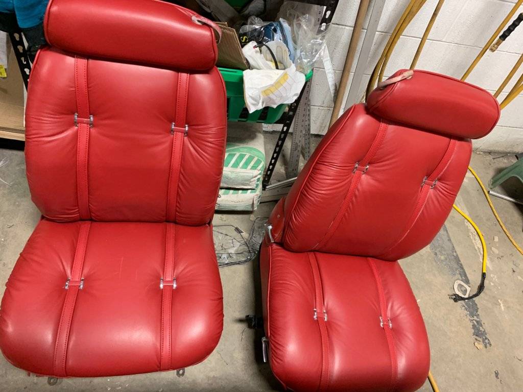

Nothing really to report Bob with being gone for 3 weeks and the crap weather we’ve been having, the poor car hasn’t had much love. Swapped out plugs for Champions and went to put new wires in and ran into this issue. Work in progress. I did however get some pictures of the reskinned 79 300 seats in full Katzkin leather from my upholstery guy....
View attachment 284048 View attachment 284049
Those seats look very nice. Katzkin's are really, really nice!

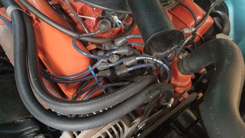

That's a good question. I'm not sure, however this set fit really well and had a 50/50 mix. They're a little messy in the pic, seems I'm always messing with that crappy distributor. They do fall in line pretty nicely with a bit of care. Key is pointing at number one.
View attachment 284632 View attachment 284633
Ah, thanks. Now that I see it I can understand how it makes sense. It looks a little funny with two different styles but definitely reduces the excessive wire loops.

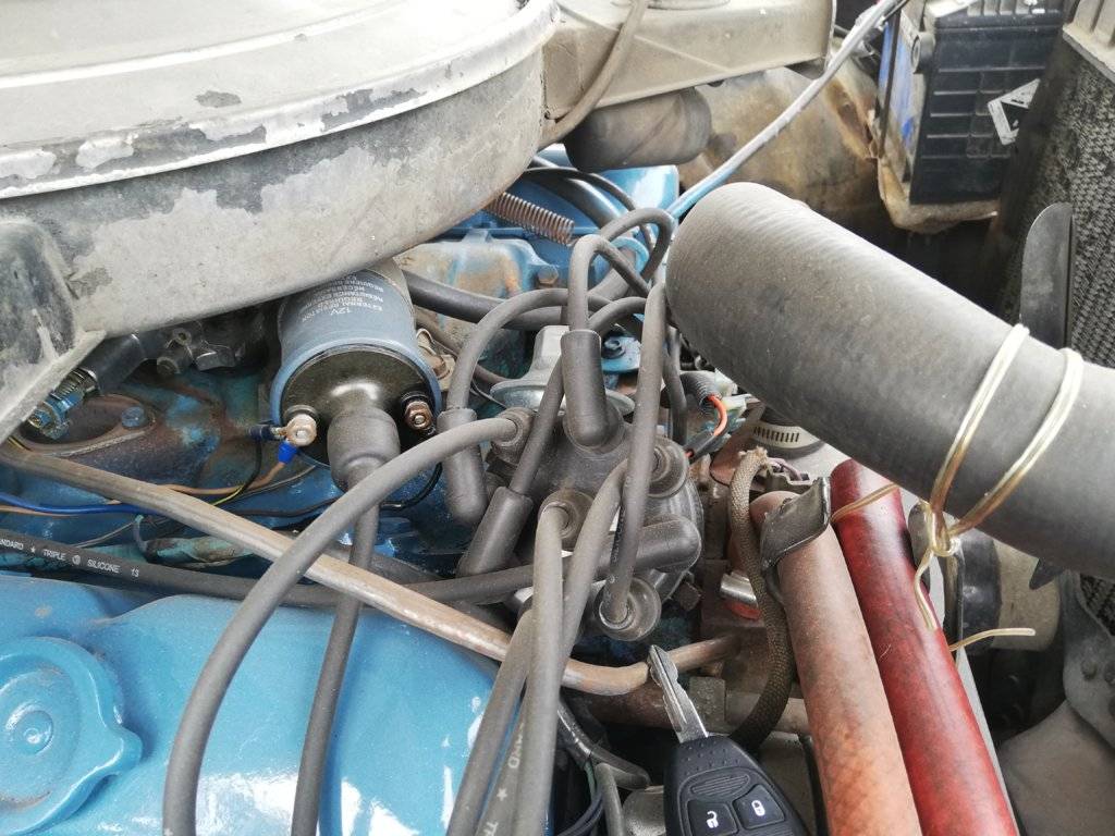

This is what my NAPA set looks like. All 90 degree. They are a Belden set, but bought 7 years ago.
