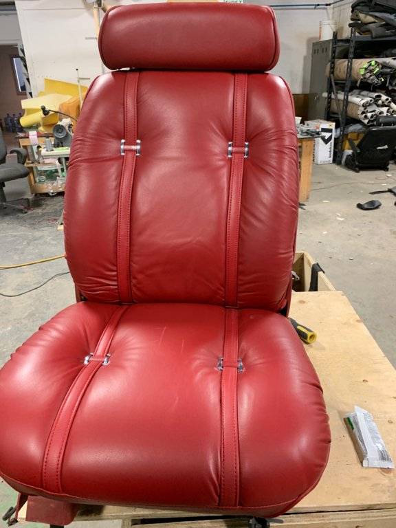

I did however get some pictures of the reskinned 79 300 seats in full Katzkin leather from my upholstery guy....
Where'd he get the cover for your seats? When i bought my 300, the drivers side was pretty rough but luckily it came with a brand new mopar replacement cover. I had that put on and now the passenger side looks crappy.. LOL
They were sewn professionally from a single hide of Katzkin leather. The upholsterer who does all our new car leather kits did it from scratch.
