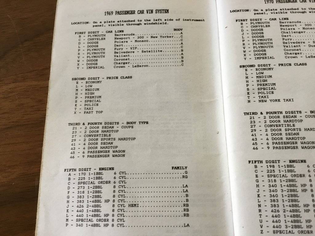

Bet that 4th character in the VIN is really a "G". They ran the VIN to see what it was and came up with that.

This is from my go to quick reference guide but I agree that it likely is a G Code car.
vin number ce27c9c285421
So the second digit, says economy class. I wouldn't think this car would be classified as economy class regardless of engine.
All Newports were "economy class."
As far as I know there were no /6 Chrysler C bodies, in any year. Dodge and Plymouth yes, Chrysler no. Without pictures of the VIN and the motor, I'd say this is phony.
You would think the guy could tell the difference? a 300 is code CM in any event. The Newport is CE, and the Newport Custom is CL.

Good luck John, but view this one as a shell and a pack of lies until proven otherwise... could become a nice car with a lot of work. If a true 6 car... an oddity with no particular value, but the C body world around you at a show will buzz.

Very surprising a Newport would have all these options and a six. Power front disc brakes, AM/FM 8-track, power windows. Something is up with those door panels. Door panels are obviously recovered and he added the 300 grill.

according to vin was special order as a 6 cyl and it was available to do so just rare

Just to be clear, this is what I originally asked him:
"You should know that this is a Newport, not a 300. Someone apparently liked the hidden headlights and switched the grill at some point. Also, there has never been a 1969 Chrysler with a 6 cylinder engine. Could you add a picture of the engine and the fender tag to confirm? The fender tag is on the radiator support just to the right of the radiator. With the correct information this might be a good deal. Thanks for your time."
Ironically, I think that if it was listed correctly with a few more detail pictures he might be able to get his asking price. Then again, if it really does have a swapped in 225 slanty it might only be a parts car.
