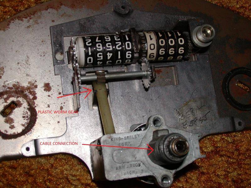

Spedo works but od & trip stopped working, any ideas?
Welcome.
The odometer gear is worn or the odometer gear assembly is broken, jammed, etc...
I'd first remove the gauge and see what's going on.
Most likely you're then going to have to look for a new gauge.

'66 should be the same as my '65 and you really want to follow the instructions in the book. It's not that hard, but there are a lot of fiddly little details that have to be done or things will get messed up.
Once you get it apart, this is what the backside of the speedometer looks like. Odds are, something jammed in the odometer mechanism, and the teeth got chewed up on the plastic worm gear.
