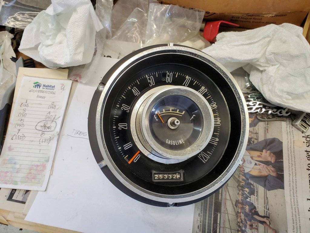

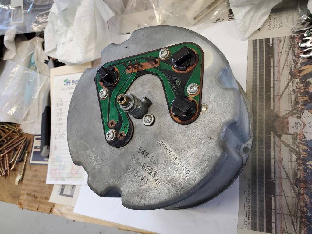

The needle wavering can be caused by the cable catching and then being forced to release from the casing's inner mesh by the cable's drive mechanism in the end of the transmission. The screeching might be caused by the speed cup bushing in the back of the speedometer head. Two separate issues, I suspect.

I would bet the bushing on the speedo head input shaft is worn out. Lube might help for a while, but, replacement will probably be in your future.
