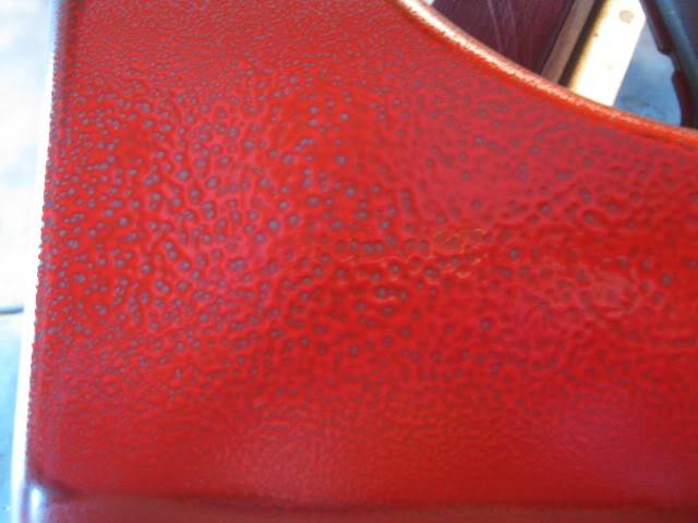

Ain't that nasty?! I'd have set it on FIRE if that had happened to me!HAHAHAHAHAHA. Gavin, That'z the ugliest picture of FISH EYE I've ever seen. LMAO THANKZ, Jer
