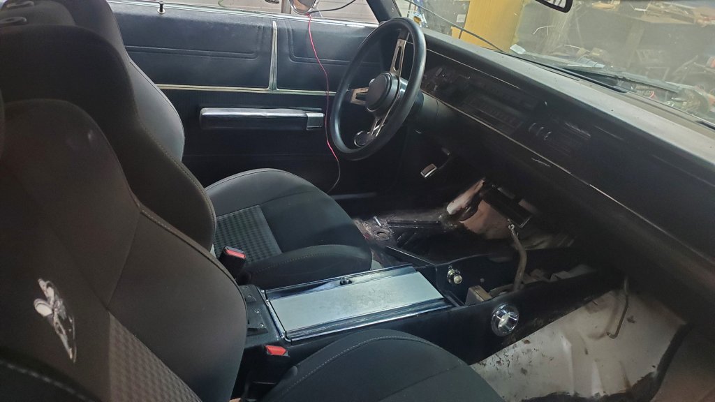

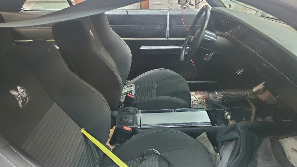

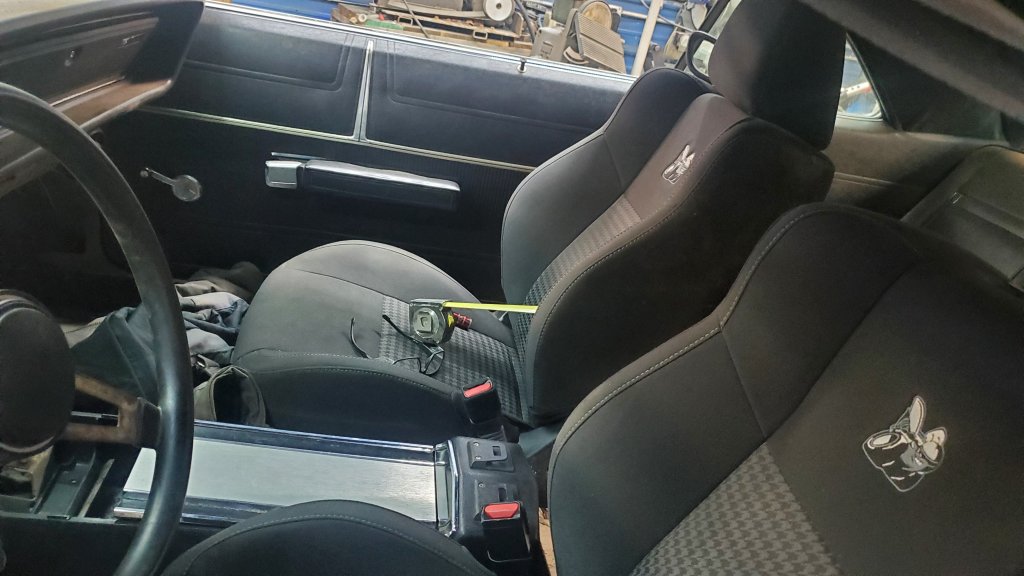

I just put 2020 Challenger seats in my 69 Newport. The seats are more narrow than the original buckets. We didn't change a thing on the seat brackets. Just used existing holes for one side then drill new holes for the other, hooked up the power and done. Will need some tweaks when I start driving her in the spring but so far incredibly easy.
Good luck with yours.
