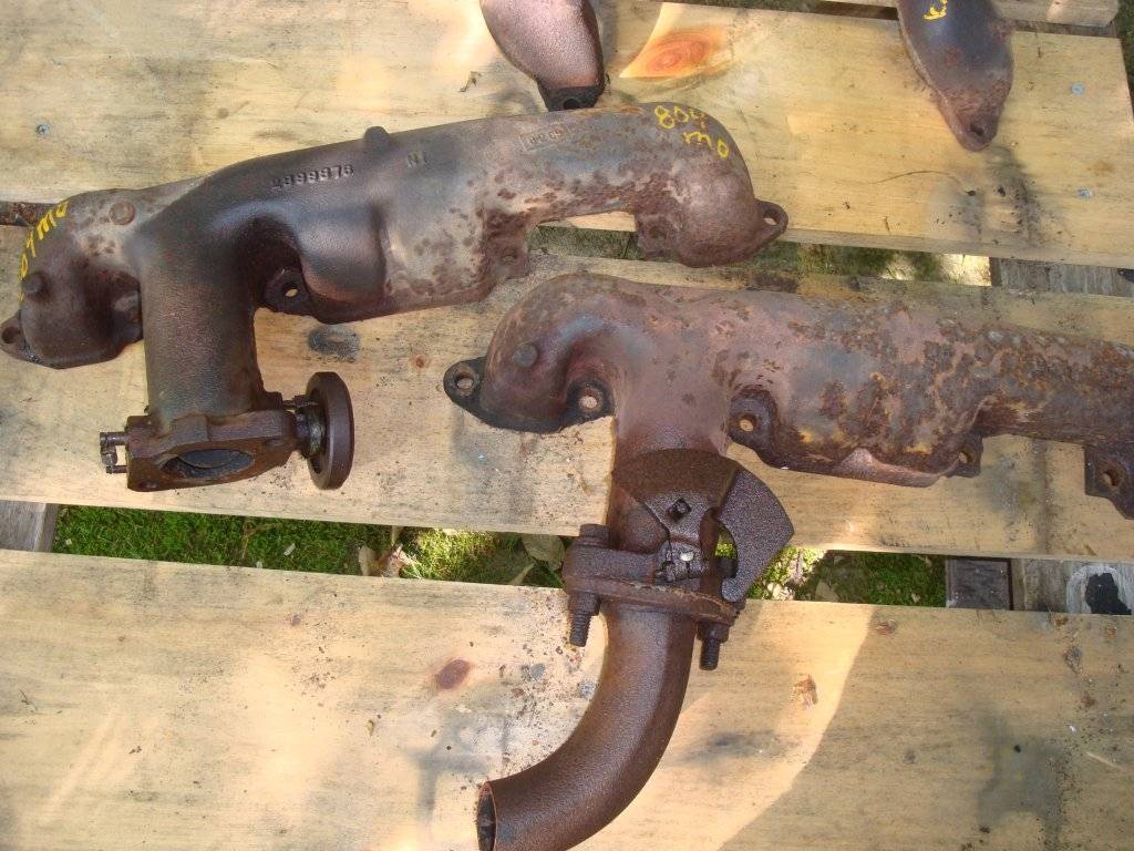

I have two sets of standard exhaust manifolds, both sets should fit a 440. The driver's sides are the same, but which one of the passenger's side would be correct for 1970? Not only do the mechanicals look different, but the flange is pointed in a different direction as well.
I don't know offhand, but googling the casting #s usually brings good results the times I've tried it.
Since my Newport is sitting outside my Office, I just went and looked. I have the one on the left, ending in 76. Now my motor is out of a '71 though, keep that in mind.
The one ending in 876 is from '72 400 & 440 with N95 which is Emission control system.
Thanks guys, I'll focus my attention on the one with the round counter weight. The one on the right came off of the '69 motor, but I don't believe it has the original heads either. My concern is that the flanges match up with the NOS Y pipe I have.
What's the part number on the other?
464 is '66 - '69 C-body big block among other applications.
