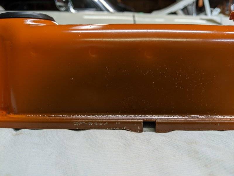

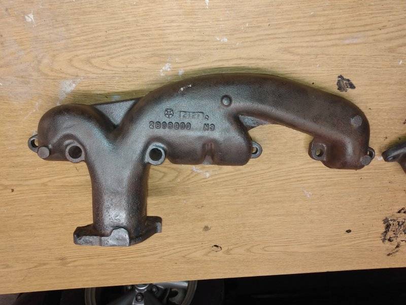

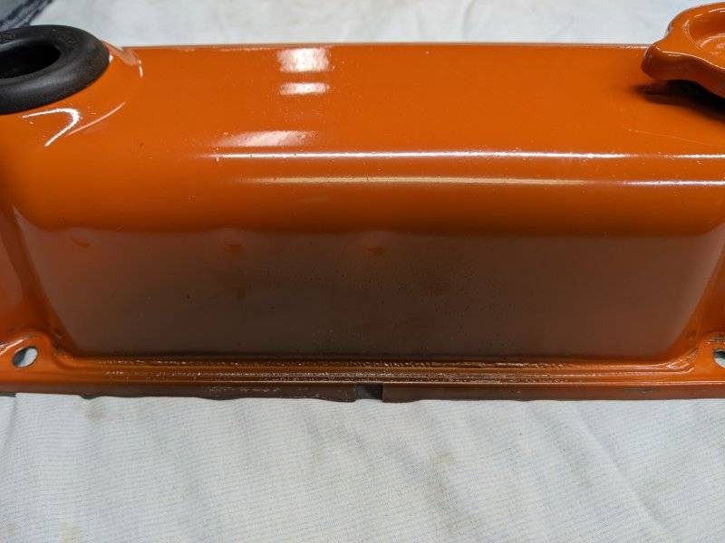

I have HP Exhaust Manifolds and I'm trying to switch to stock 1970 Valve Covers. I used Chrysler Race Hemi Orange to paint the valve covers. I did not use primer. Clearance on the right side from HP exhaust manifold 2806900 to the valve cover is tight. After 30 miles of driving, I had burnt orange. I have already tried Duplicolor Hemi Orange. It flakes badly, in addition to being runny. Does VHT SP120 stay orange long term in this high heat proximity to an HP Exhaust Manifold? Is there something better? Thanks. I really don't want to keep painting these valve covers. Problem is happening to a lesser degree on driver side.
2806900 HP Exhaust Manifold fits B-Body & C-Body Right side
Cannot take the heat
Close Proximity mount
Race Hemi now burnt orange

I believe it's fel-pro that makes exhaust gaskets that have a large rectangular tab that sticks up in that area to prevent this from happening.
FEL-PRO MS90425. Listed for 1974-78 440.

No, there were no gaskets from the factory. I believe this is the nature of the HP manifolds, and why someone stepped up and made a product to help.

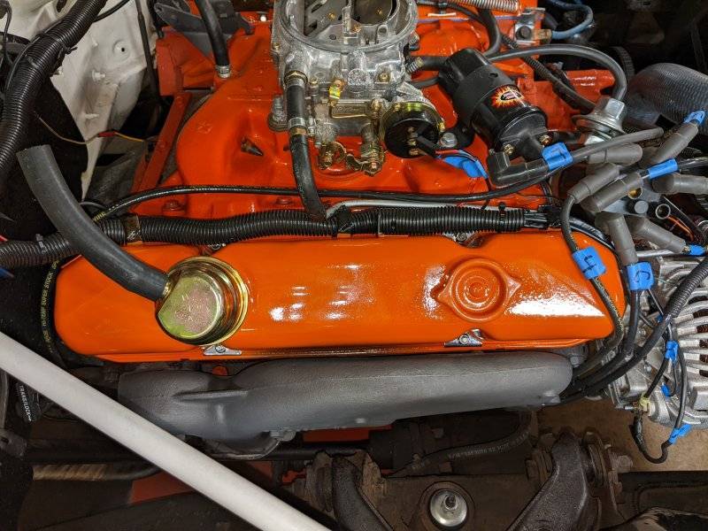

my 78 440 powered truck came from the factory with those exhaust manifold gaskets that protect the valve cover gasket. When I built my 70 Challenger six pack car I added one of those gaskets on the right side of that engine because the manifold is real close on the right bank but no so much on the left.
Here is a pic of my 78 engine. I still have the extra gasket if you wanna try it. It helps save the paint and gasket for quite a while. The gasket itself is a Mopar PN: 4095786
Yes, that is indeed what they do, even from the factory on day one. I have a 70 Hurst with the HP manifolds on the 440 TNT motor. Not only will the valve cover paint turn a burnt orange over time, if you use cork valve cover gaskets they'll dry out and start to leak, too.
Tons of heat generated from those manifolds. I tried priming first with high temp exhaust manifold paint before the hi temp orange and it helped somewhat. I also added those exhaust manifold gaskets with the extra rectangular material to block the heat from the paint.
Also, keep an eye out on your spark plug boots/wires, as they cook faster than on non-hp engines and can result in a rough idle due to cracks in the boots and arcing. Passenger side is worse than driver's side as it's closer. I assume your intake manifold also cooks above the crossover passage? Hurst is a factory a/c car with fiberglass hood, which also seems to hold in more heat. I've had non-hp motors like 383/400 with non-hp manifolds and no such problem.

I had to use heat socks over spark plug boots by outlet passage of manifolds. Melted #7 wire and replaced.

Thanks, but Heat is also bubbling paint on left side valve cover. I need full gasket set.

In my case, on the Hurst, it's not the stock 350 hp 440, but the 375 HP TNT version, like the Super Commando in Plymouth and Magnum motor in Dodge. It has much different exhaust manifolds (factory headers, if you will) that sweep up above the spark plugs and are very close to the valve covers compared to the 'log' manifolds that are much lower and further away from the valve covers on lower performance engines.
