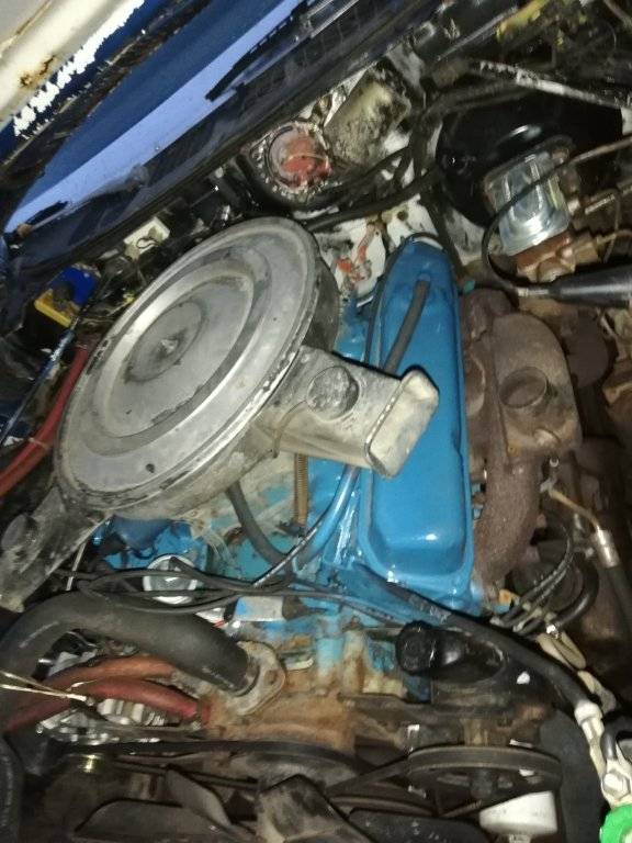

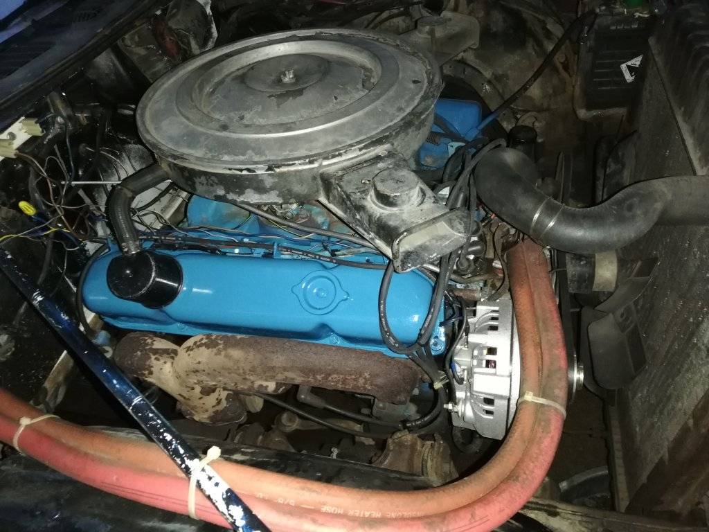

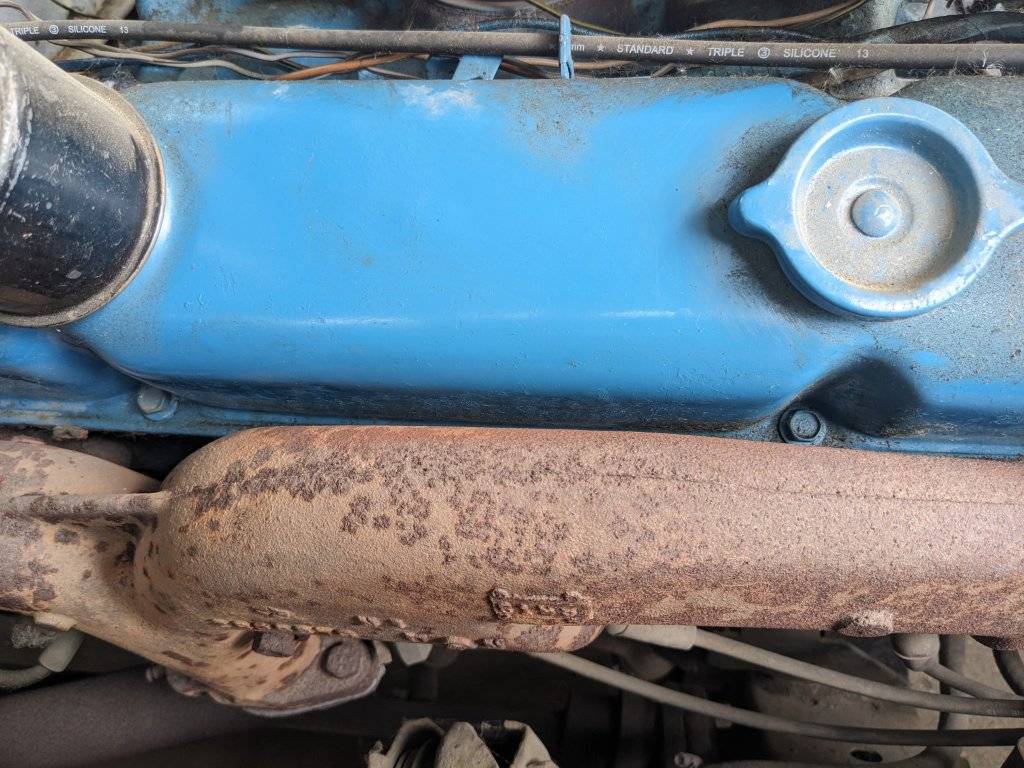

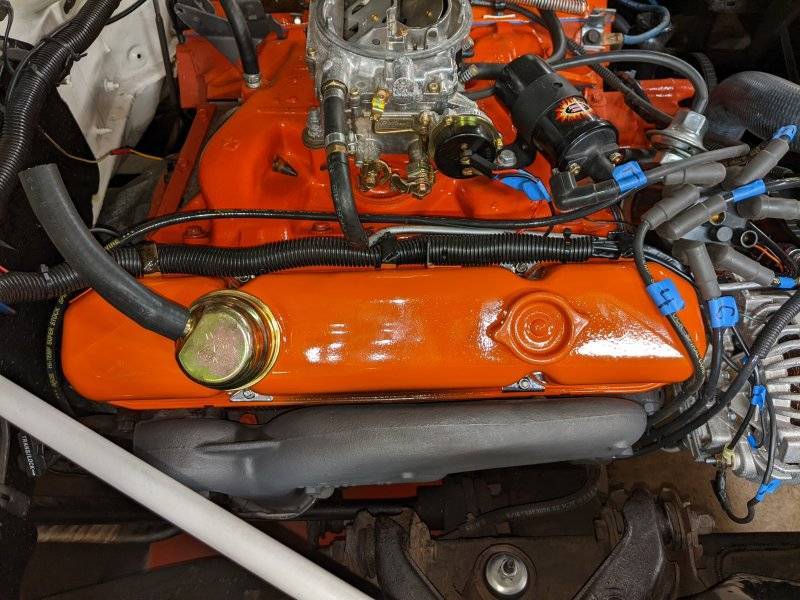

Here's my '70 440, car originally was a 383-4 hence the manifolds and air cleaner. I was told it was rebuilt to HP specs, but who knows? It doesn't burn a drop of oil, and goes like a cut cat. First pics are from 2018, quick degrease, brush, scuff and spray job, no
primer as well. Not a ton, but a whole lot more that 30 miles on them since then, no burning. And I do give 'er hell on regular occasion. Second (dusty) pics from yesterday.
To the OP, or anyone else, enlarge the picture of the down view of the manifold and valve cover and notice the clearance gap from rear vs front, rear is more, middle & front are closer. Maybe just maybe in the engines lifetime the exhaust manifold was resurfaced as in this video?

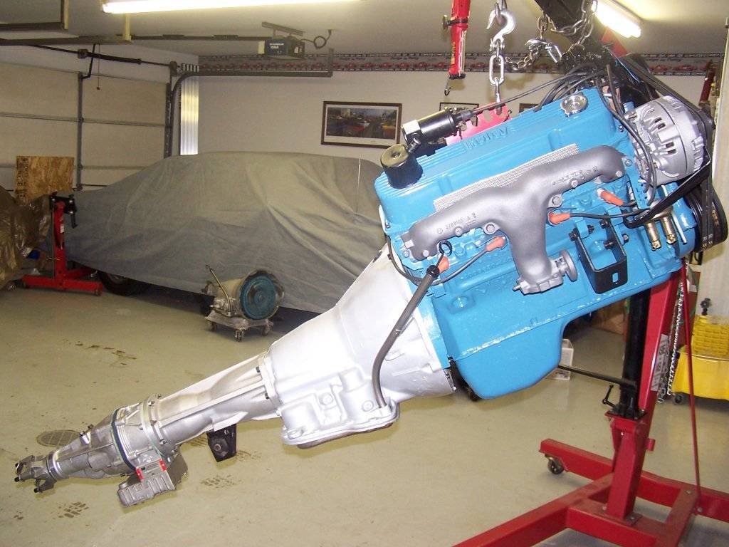

my 78 440 powered truck came from the factory with those exhaust manifold gaskets that protect the valve cover gasket. When I built my 70 Challenger six pack car I added one of those gaskets on the right side of that engine because the manifold is real close on the right bank but no so much on the left.
Here is a pic of my 78 engine. I still have the extra gasket if you wanna try it. It helps save the paint and gasket for quite a while. The gasket itself is a Mopar PN: 4095786

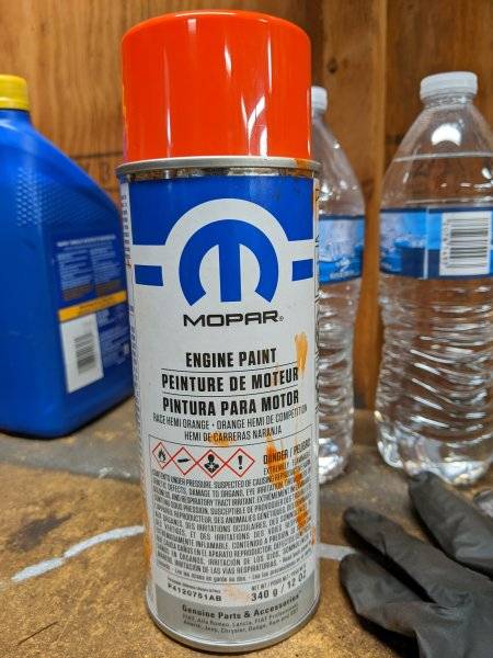

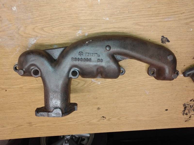

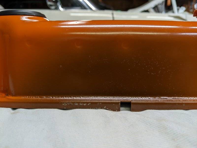

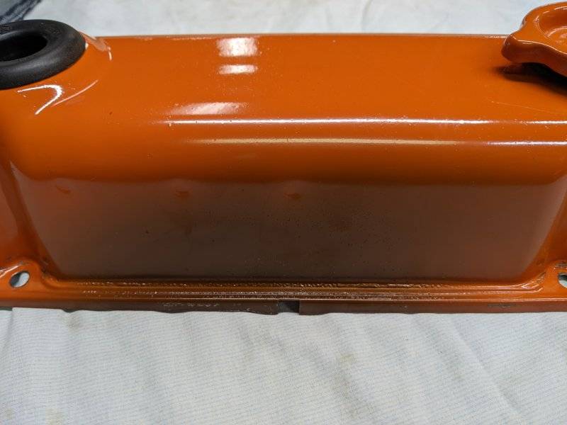

I have HP Exhaust Manifolds and I'm trying to switch to stock 1970 Valve Covers. I used Chrysler Race Hemi Orange to paint the valve covers. I did not use primer. Clearance on the right side from HP exhaust manifold 2806900 to the valve cover is tight. After 30 miles of driving, I had burnt orange. I have already tried Duplicolor Hemi Orange. It flakes badly, in addition to being runny. Does VHT SP120 stay orange long term in this high heat proximity to an HP Exhaust Manifold? Is there something better? Thanks. I really don't want to keep painting these valve covers. Problem is happening to a lesser degree on driver side.
2806900 HP Exhaust Manifold fits B-Body & C-Body Right side
Cannot take the heat
Close Proximity mount
Race Hemi now burnt orange
