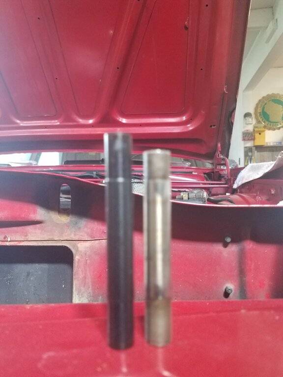

Here's the fuel pump pushrod that I removed (with much time and effort...grrrr) from the Newport and the new one next to it (made in the good ol' USA) Big Red is happy again and so is its caretaker...too bad it took me 2 1/2 days to get it repaired. Missed Volo...again!

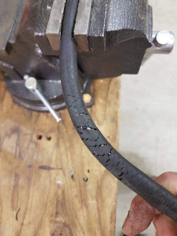

Update - change out the fuel pump and filter yesterday. Pulled the pushrod to compare to my NOS ones, no wear detected, so the NOS ones will go back into the box. Replaced the rubber lines from the stub-frame hard-line's nipple to the pump and the unions to the fuel filter. All the other rubber lines from the rear of the stub-frame and those at the tank were nice and supple and dry - no evidence of checking or seepage. Check out the rubber line I replaced though - yikes!!
I figured "Well, there's your issue!", as the fuel pump seemed to be just fine (but I replaced it anyhow - it's at least 25 years old)...
