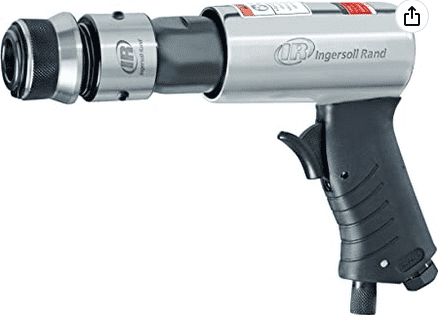

man, i hear you. but i stopped fighting 30 years ago. i found that i don't get paid enough to actually labor. i let the pneumatics do the work. in this case i'd use one of these with a blunt chisel to get that coupler off the box. braaaap, and it's off.

I have been dealing with Jerry at Lares.....and sent him a note on this because I thought they may have the part.......so I will look at the 220. Problem I have is that many of these do not even give you the bolt spacing....some do. So, will pursue for best replace. thanks....again John.
