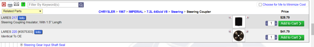

When I looked at Lares 217 I got this: Steering coupler insulator
And the picture is this:
Stan is correct, that would fit my 64.

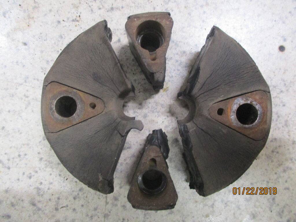

I'm not yet to that stage in my restoration, but do you advise to buy one just in case?
Is it a part that's always damaged, or can it still be in good shape after 50 years ?
Rubber doesn't age well. It gets hard and brittle over time. It's even worse because it's in a bad spot, near the exhaust manifold, so it tends to harden and crack from the heat. What looks OK visually may fall apart when you remove it. If yours has never been replaced, it's a safe bet that it needs to be. Even if it's been replaced once in the life of the car, there's a good chance it's bad if that was more than a few years ago.
No matter what, it's part of the steering. Do it once and do it right.
I suggest giving it the hairy eyeball. They do deteriorate and when they break it's always at the worst possible time. If you see any cracks at all, replace it.
Mine broke when driving around a corner in a parking garage. Fortunately there was an open spot I was able to maneuver into. Otherwise I would have needed a tow truck. I would have blocked everyone from exiting the garage. Got lucky on that one. That was back in '86 or so. I was able to find one at a nissan dealer that turned into a chrysler dealership. The parts guy had to go through a couple parts books to find the right number. But I was able to order a new one. Good luck with that today.

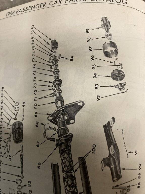

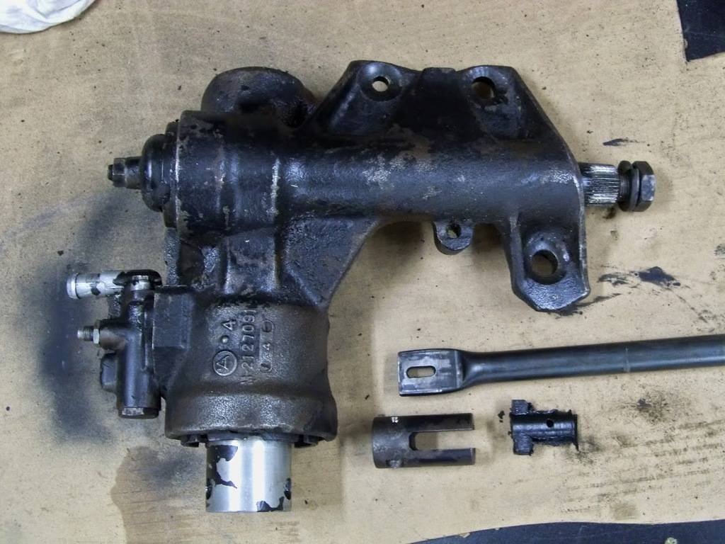

FYI, for those not aware - not every C-body listed below uses this coupling, it is only those with certain steering columns (IIRC ones made by Saginaw?).
My 65 Fury and 65 Chrysler use it.
My 68 Fury does not.

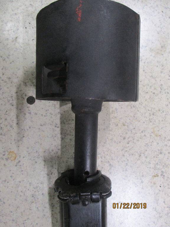

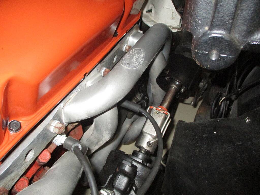

Every installation I've seen has a heat shield around it, make sure you've got one in place. The 'early' cover is a half-clamshell style, the later one is a cylinder with tabs for bolting it on.
Yes, indeed. Without that heat shield the coupler will soon be baked. My 70 has the cylinder style that you mentioned. Removal and installation of the thing is a bit of a fiddly pain, and I imagine many were tossed aside by a mechanic working on "book time" many years ago.
