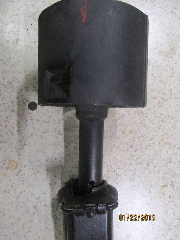

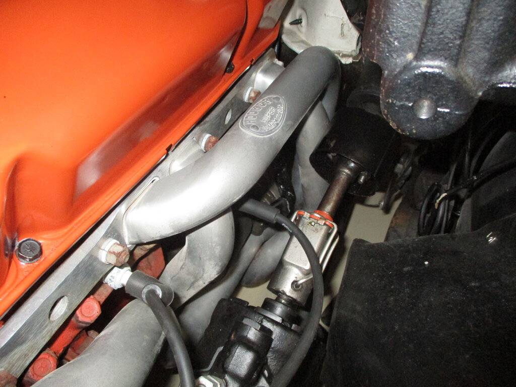

Yes, indeed. Without that heat shield the coupler will soon be baked. My 70 has the cylinder style that you mentioned. Removal and installation of the thing is a bit of a fiddly pain, and I imagine many were tossed aside by a mechanic working on "book time" many years ago.
View attachment 496688 View attachment 496693
I think they also were prone to rusting and tossed when the mounting ears gave way.
It was missing on my car, most likely left off or removed during repair. I'd wager that some bought the farm during engine swaps too as they just look like something the engine would hit while swinging from the chain.
Bottom line is they are a bit fragile. I'll even say that the mounting ears were damaged by overtightening to the point of not being serviceable after a coupling replacement when it was installed on the assembly line. Of course, the cars weren't meant to last 50 years either and many cars never had the coupler changed in their lifetime.

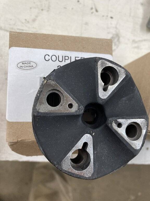

I had a hard time finding a decent replacement and even that needed some work. This would be really good part to repop!
I went through this coupling bullshit ONCE. That's all it took.
If asked what to do now? Dump it for a new u-joint.
That’s disappointing…:soapbox:
Stuff from China these days isn't what it used to be. Stuff from Centric is very good, even better than original brake parts in my opinion.

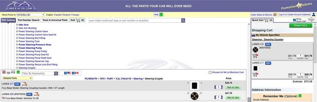

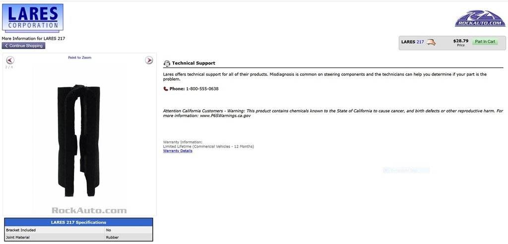

They list this also #217....is this thing necessary?Should it be ordered because it's hard to find?
Rock Auto #217 is the insulator for the blade and slot style of steering shaft used until about 1964 and before. A copper strip is also needed to complete the ground path for the horn. No horn function with out that.

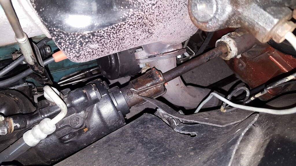

Looks like my car doesn't use this coupler. While this isn't my car, it is the same shaft my car has.
