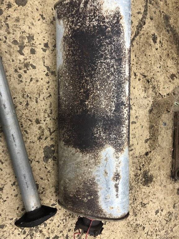

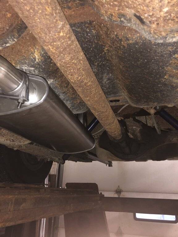

Almost a year ago I had a local shop fab pipes to replace a very rusted and broken original single exhaust on my ‘67 Newport sedan (383, 2 bbl), and the original muffler was 24” long. Here’s some photos of the old system and what replaced it. The muffler was stamped with the Pentastar and number 17806, which I think is the same as a Walker number. The pipe ahead of the muffler looked to have had a small stretch of resonator built in. The replacement system has a similar muffler, no resonator in the pipe, and has a nice hum from outside but SO quiet inside. As a low-optioned near-original sedan, quiet seems appropriate.

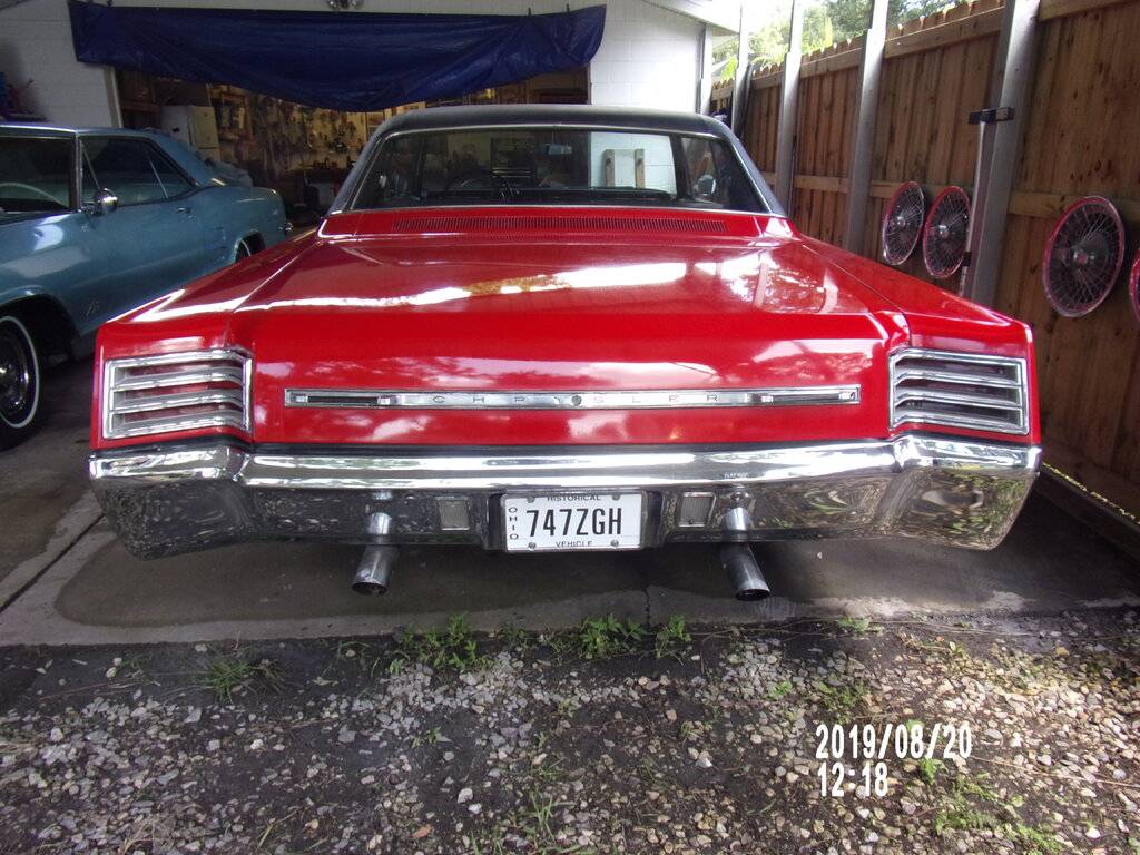

Thanks as always fellas for your advice. I took the car to the muffler shop yesterday, and got the "old guy", Charlie on the case. He tells me that the mufflers the first shop put on were super el-cheapo, practically hollow with just one baffle. They were designed for maximum flow and maximum noise! Charlie created an H-pipe between the two downpipes, added much better mufflers, and brought the tips in a few inches. Everything was welded, great looking job. Now the car is nice and quiet, and looks better with the tips shortened. Cost me $500. I'm very happy with the result.
