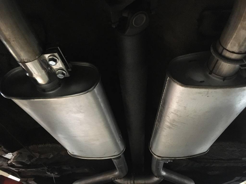

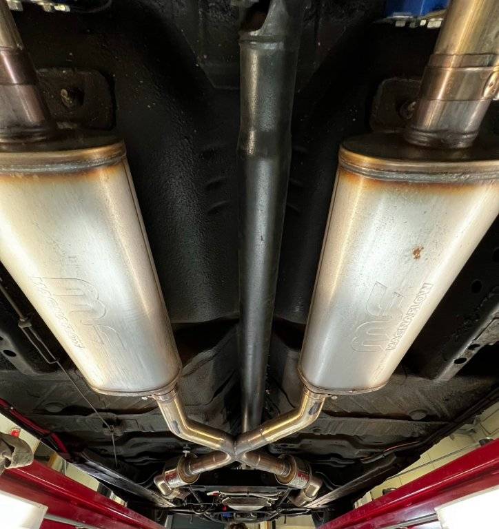

For the 2 1/2" TTI exhaust, yes it is a direct fit.
Turbo on top, Caddy on bottom in this pic.
Caddy on left in this pic.

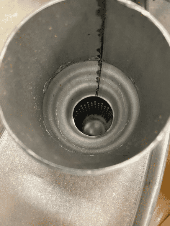

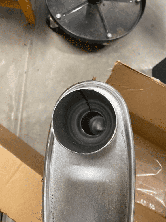

Did your Caddy mufflers neck down to a 1.5" baffle? I was looking at reviews on Summit racing site, and a buyer was not happy with finding that the muffler inlet decreased in size.

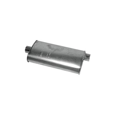

A couple of the photos for the part number Walker #21856
