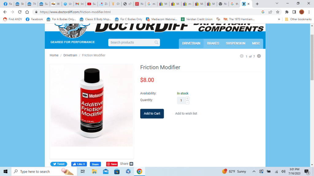

Dr Diff. Friction Modifier. He sells Motorcraft but that's ok.
