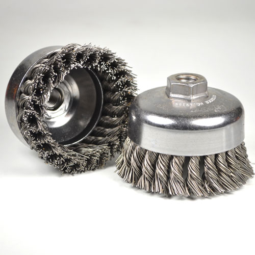

After a vigorous workout with this first of course:
Finally, encapsulate the treated area with an OIL BASED paint such as Rustoleum.
