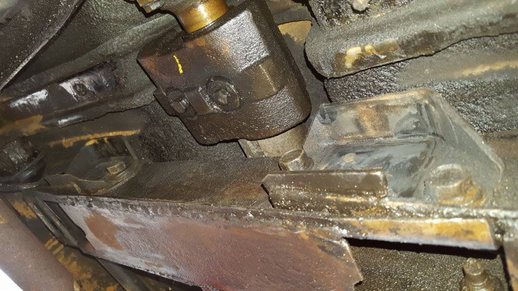

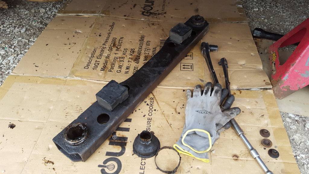

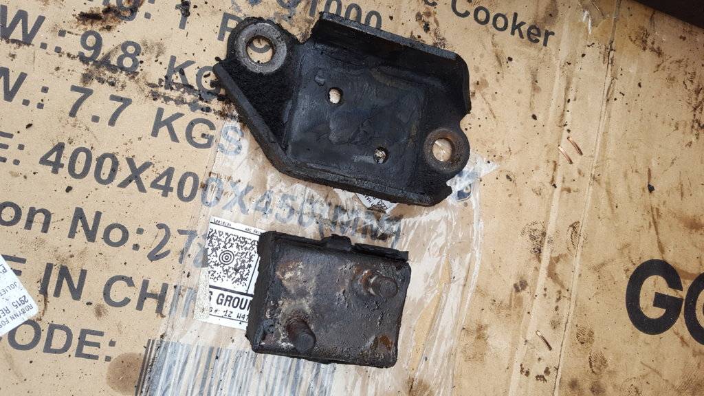

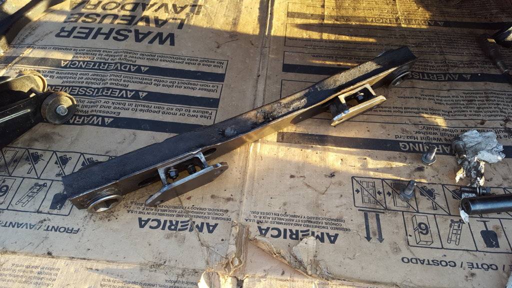

Here's a picture of the extra crossmember that the isolator bushings mount to.
You can see both rubber bushings have split into two parts.

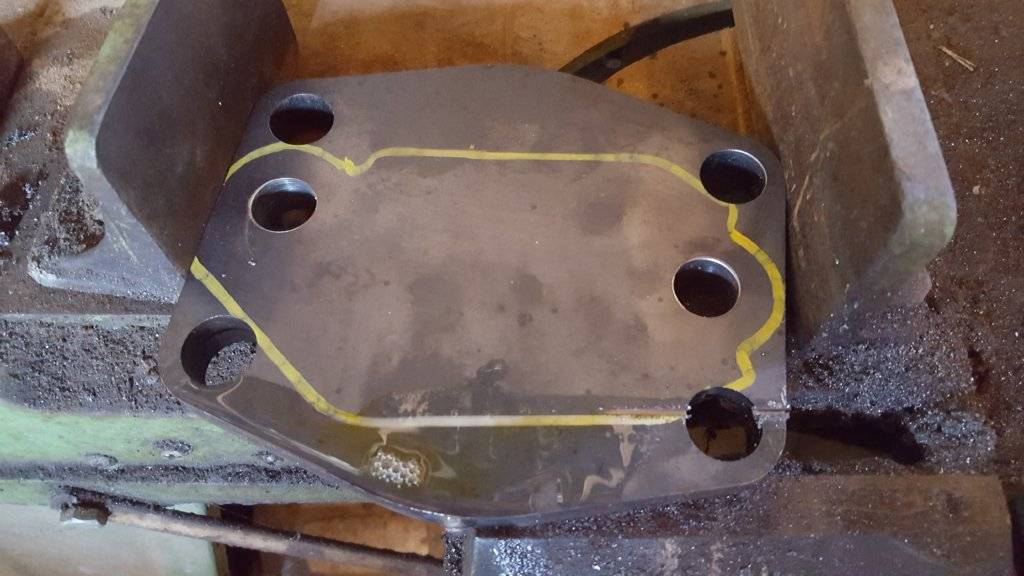

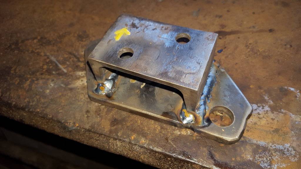

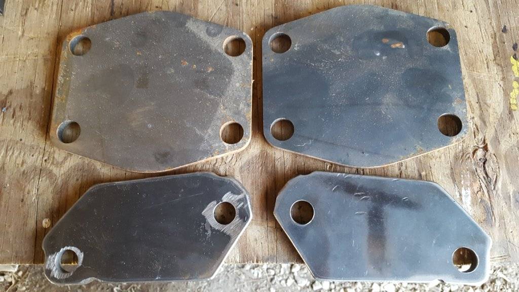

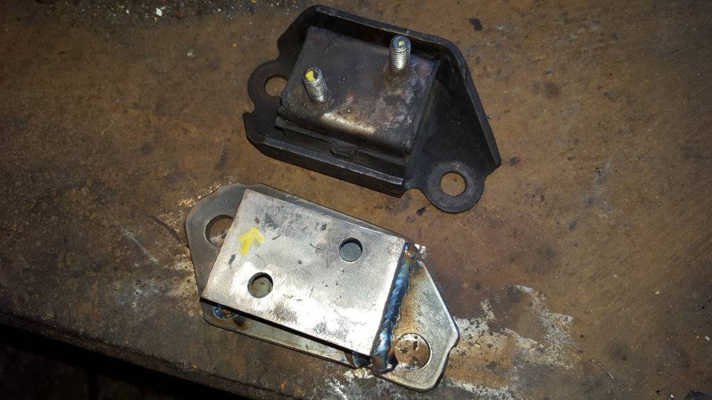

Haven't sent the bushings out to be rebuilt yet, so in the meantime I fabbed up solid mounts out of some scrap.
Instead of studs, bolts and nuts should make assembly easier
I left things a bit loose until it was up in place.
Solid mounts, why not?

How does it ride with the solid mounts?
