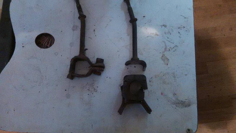

Hello! Well here's the plan for the Non-Repairable Sway Bar! BALDERDASH I SAY! Nothing is unrepairable! as long as you got a Cutting Torch and a Welding Machine! I found two different Sway Bar Links on this car, which leads me to believe, the one that will accept the split bushings, is an aftermarket, but nonetheless it's a good idea. So I'll fab up a duplicate of the open Clamp and beef up the Rod from 3/8 to 1/2 inch and redrill the Hanger. IMG_20150607_154050.jpg
