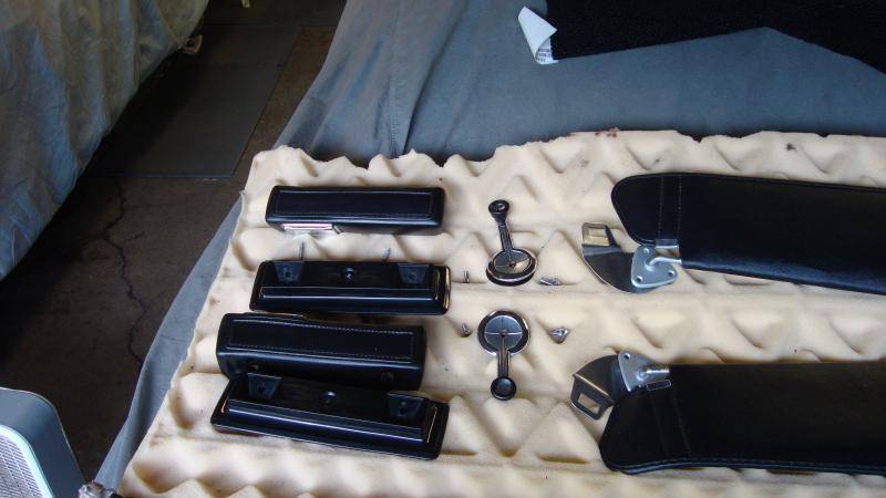

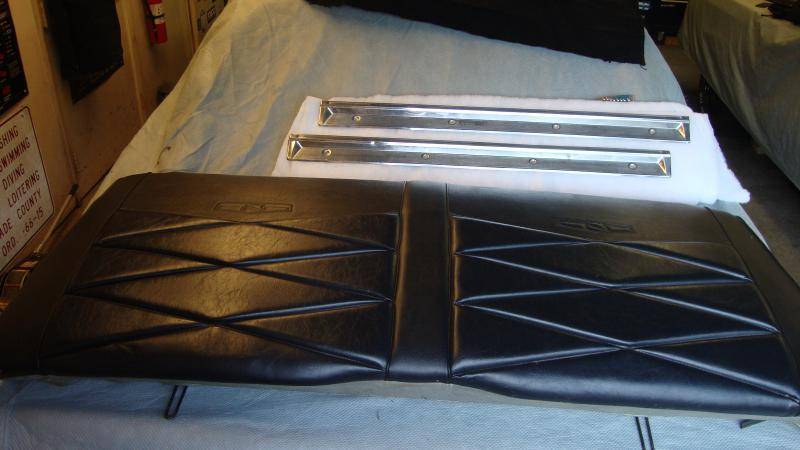

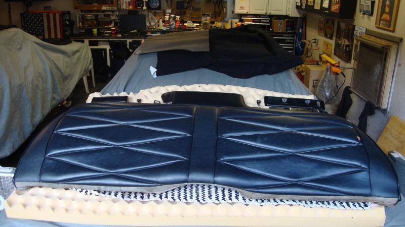

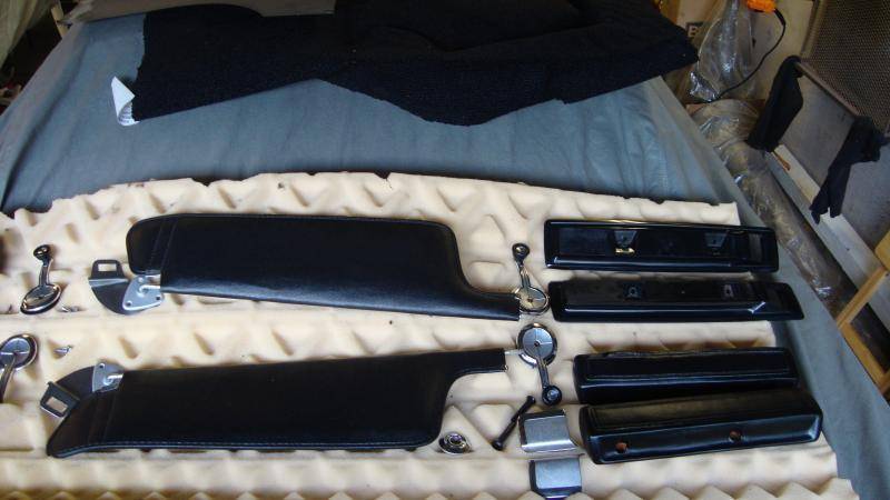

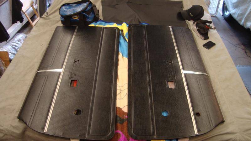

A little more progress today...lexol'd all the soft parts and buffed all the {pot} metal parts. Quite an improvement if I do say so myself. lol
the bottom part of the back seat had some what looked like nail polish on it...took some non-acetone acetone and took it off.
still have to lexol (clean and condition) the seats themselves, remove the a-pillar trim and the rear window trim, and take out the package tray and re-paint it.
once all that is out, I can take the headliner out to scrub it clean and replace the insulation.
If you're going to do it, do it once and do it right!
You can kinda see where the non-acetone acetone left a little blotch on the seat in the first pic. it's a helluva better than purple nail polish though! lol
