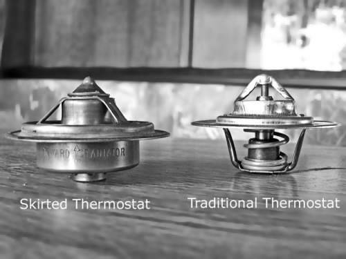

  1. What exactly is the difference between a skirted thermostat and a non skirted one?

I believe the "skirted" T-stat is just that, it has the "skirting" around the bottom around the center section. What we generally see in T-stats and what I also use, it the flat disc type where you can see the T-stat workings in the center - no skirt hiding it from view.
I would assume the Gates T-stat is like most conventional T-stats we are all familiar with. I am sure it will work just fine and probably what most use. The "skirted" T-stat may be more like original, but I am not that much of an expert to confirm that the originals were of the skirted style.
