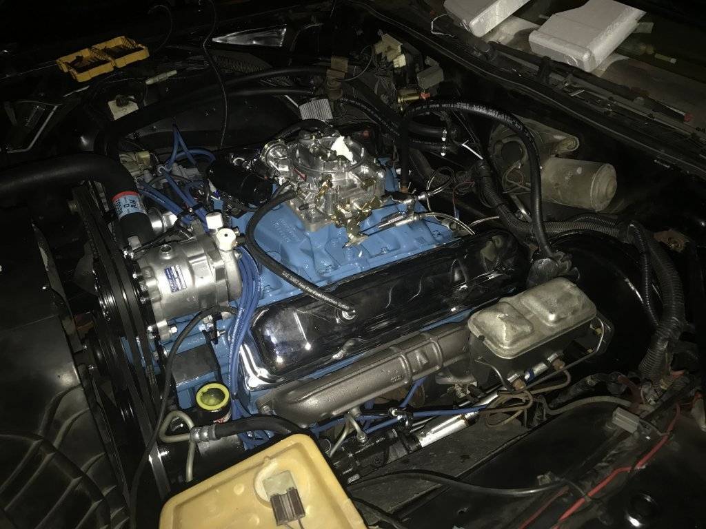

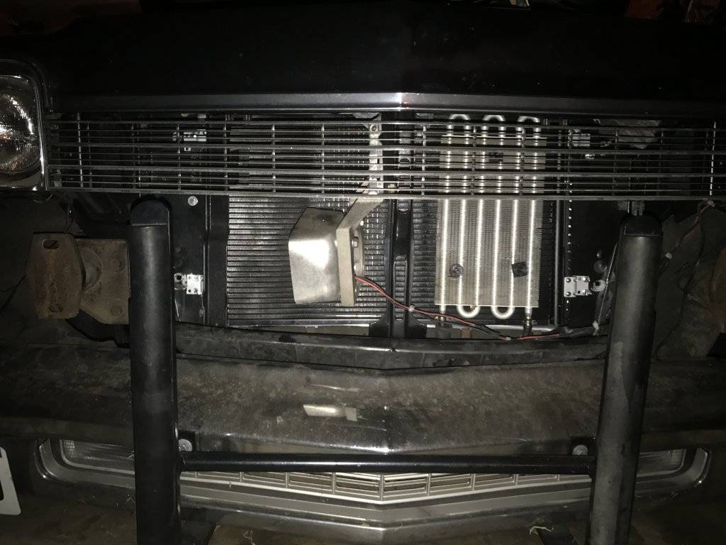

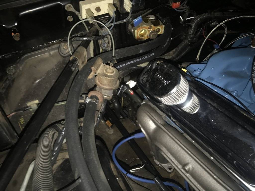

Judgement day is upon us! Power steering hooked up, new a/c condenser installed, along with the aux trans cooler, and new trans dipstick. Lokar throttle cable, bracket, and kickdown cable installed. Tranny cooler lines are hooked up. Not the happiest with them. Tried 2 diff flaring tools to no avail. Maybe the steel line is cheap? Idk.. but myself, and a friend could not get em to flare. So has 1/8 to 5/16 nipples on for now. Goes rubber steel then rubber. Will prolly have these re done down the road when she's operational.

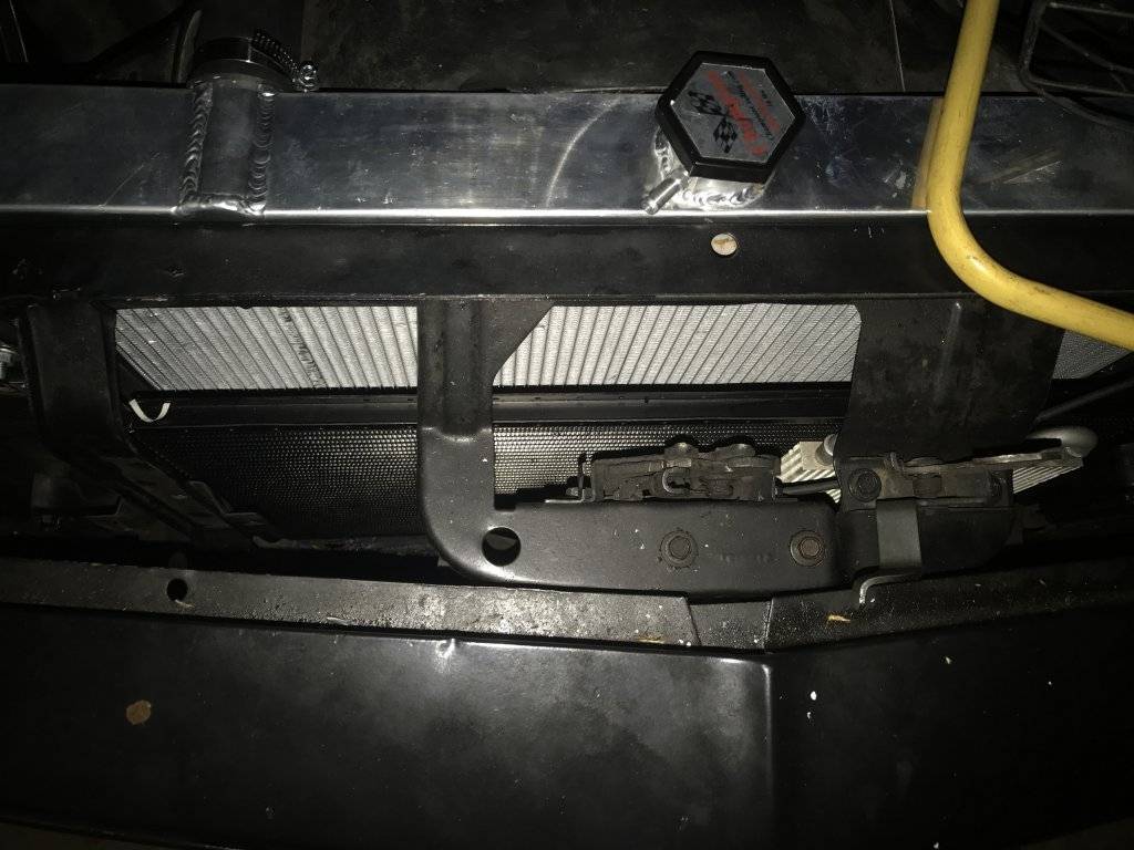

Radiator is filled with coolant, and motor filled with comp cams break in oil. Feeling a little iffy on the valve covers... had a tiny seep out of one of the bolts when filling. Tightened em all up a little more. We shall see. Other then that no leaks. Yet!
Are you doing a double flare?
There's a few tricks. Deburr the tube inside and out. A dab of grease helps too.
Cutting the end with a Dremel and a cut off wheel might help. Using a tube cutter sometimes "work hardens" the end of the tube, especially if the cutter is a little dull or you used to much force to cut it faster.
Never done it that way, but the bigger tube is a little harder to work. I would expect trouble from the smaller 1/8th tube, it's bound to create pressure where there should be none.
Muwahahahahaha!!! IT'S AAALLLIIIVVEEEE!!!!!!!!
My buddy came over to help for the day. Only had 2 hiccups. Starter wires weren't tightened down all the way. Wouldn't turn over at first. But fired after tightening. Next was the new hei dizzy wasn't wired correctly. After messing with it for an hour or so got it figured out. She came right to life on first bump of the key!
After 30 mins of break in topped the trans and power steering. Also played with the timing and carb a tiny bit. Running real good so far!

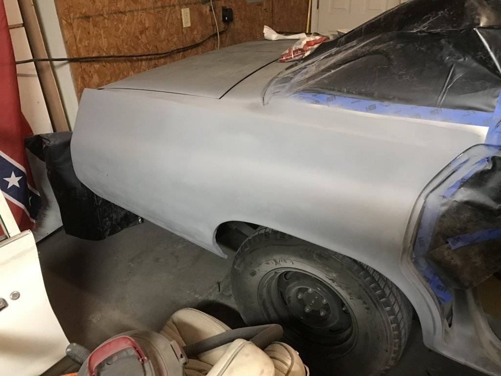

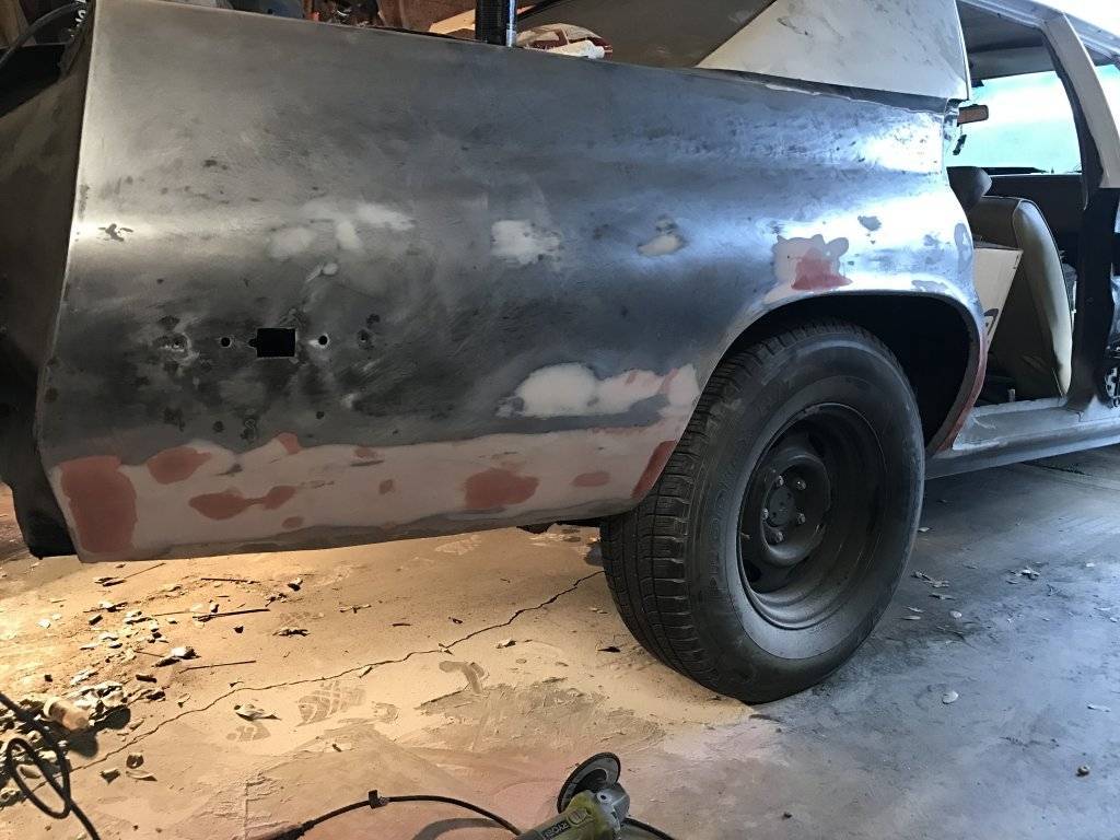

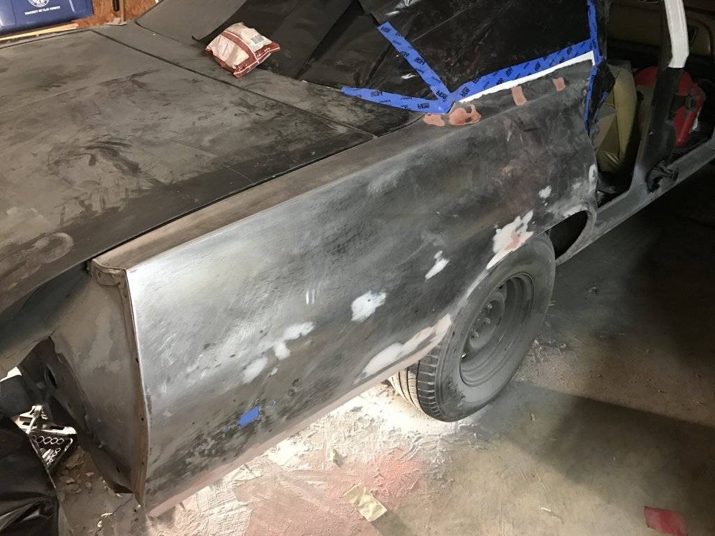

Going in sections. Passenger side is done( except for a final sanding before paint). About half way through on the driver side. Gotta sand it down again, and add another layer of filler.
Rear bumper is NOT coming off. It didn't want to last time, but figured I'd try again. Gonna make things a little more difficult. Plus I can't pull the plastic filler to paint.
