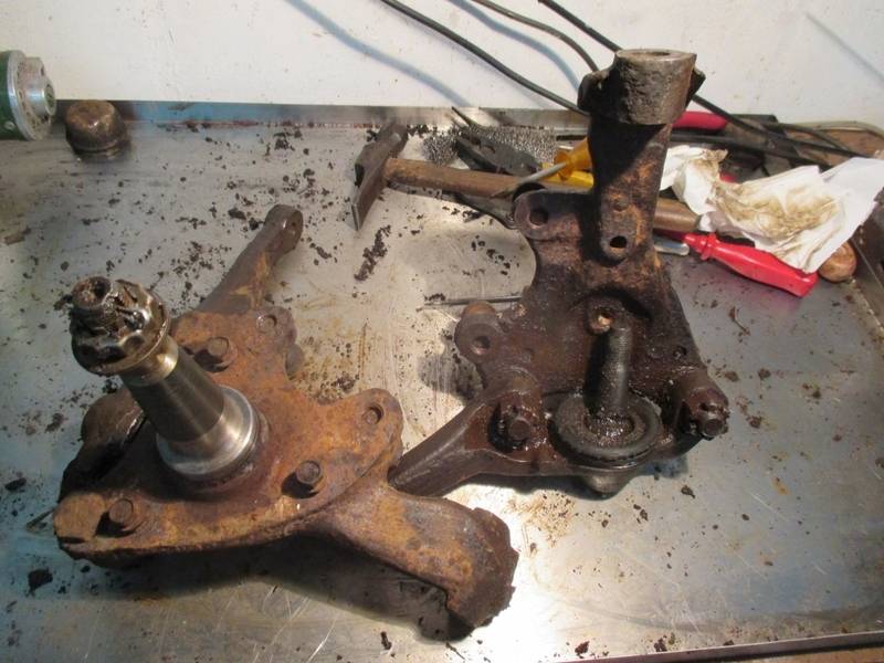

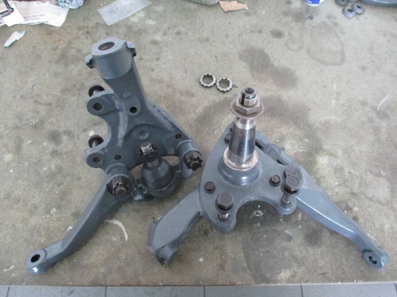

I found some 73 spindles on Facebook. They were advertised as rough but usable, so I took the risk. When they arrived, they looked like they belonged on a car that was left to rot in a swamp for a few years, but they were indeed salvageable.
I first tried to derust them with vinegar, but they were far too gone, so I had my father derust them with electrolysis. I bought some new ball joints from P-S-T, and after a lick of paint they looked (nearly) brand new.

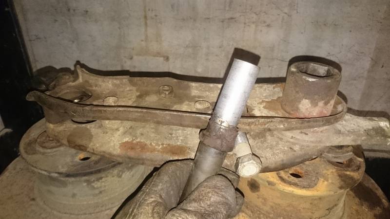

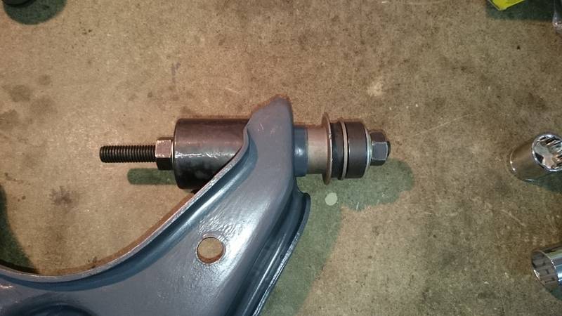

I removed the upper ball joints from the upper control arms while they were still attached to the car, then derusted and painted them. However, even though the threads look perfectly fine, when I tried to screw the new (Moog) ball joints back in, they didn't want to go in. I had to lightly turn down the first few threads on the ball joint, and hand file the threads in the control arm so the ball joints would engage. Never read or heard someone have a similar problem. The bushings went in without any problem with the Mancini tool.

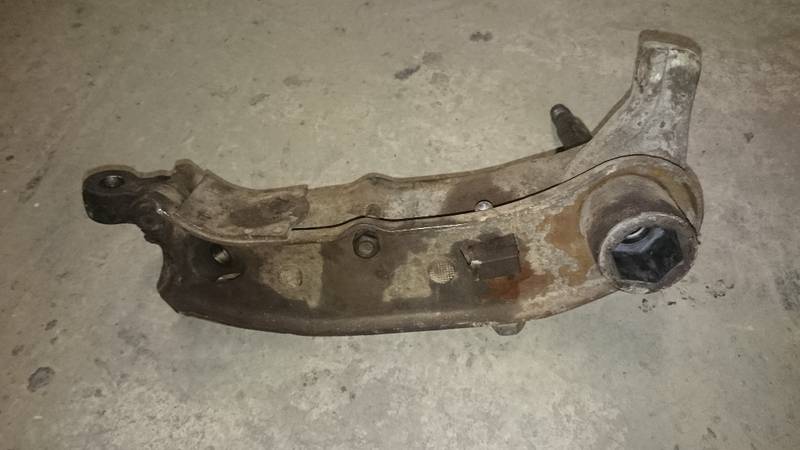

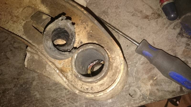

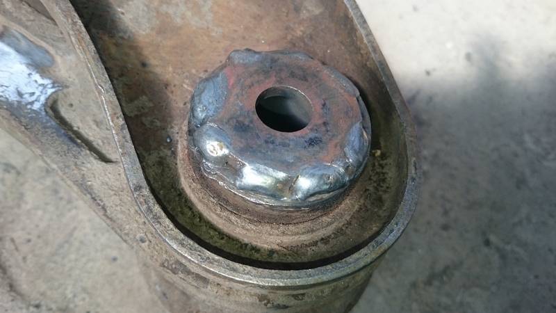

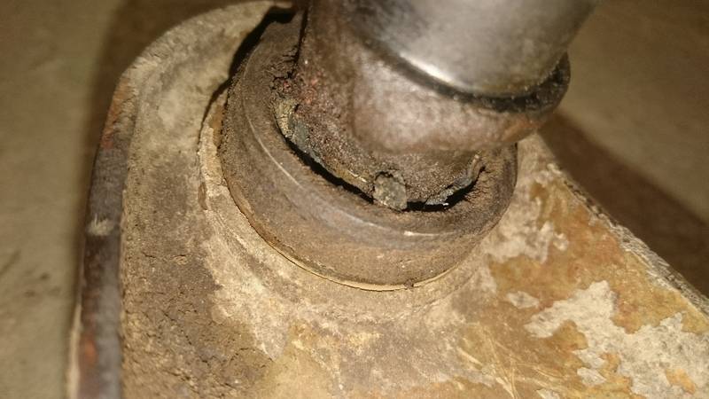

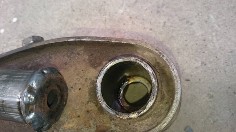

Next on the list, the lower control arms. I was kinda fearing those ones, but all went well. To remove the existing bushings, I used the weld & press method I found in an article online. I removed the inner shell with a press and the rubber with a screwdriver, then I welded a washer on the outer shell and pressed it out. To remove the inner bushing shell from the shaft, I made four cuts with a cutting disc and removed it with a chisel.
(Excuse the bad quality of the pics, they were all taken with my phone)
DSC_0363%201024x576.jpgDSC_0369%201024x576.jpgDSC_0375%201024x576.jpgDSC_0377%201024x576.jpgDSC_0378%201024x576.jpg

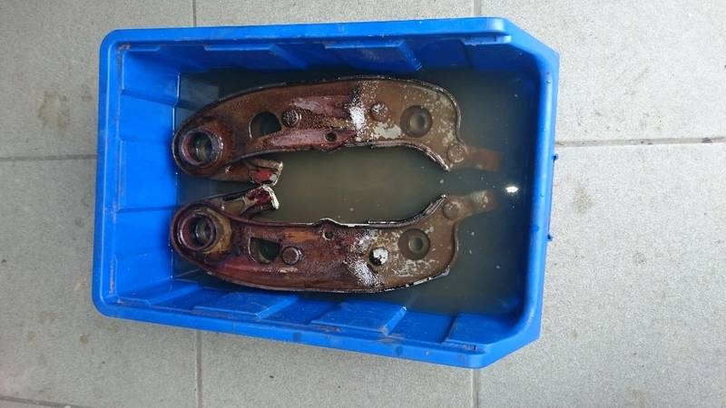

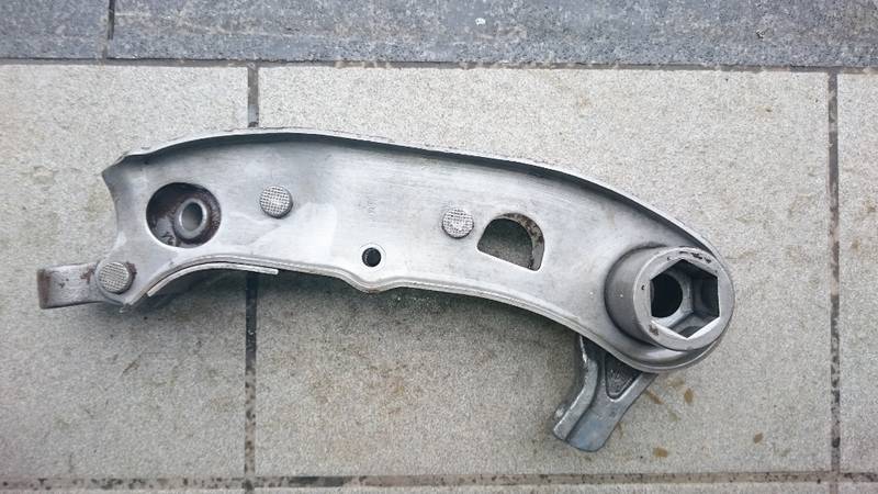

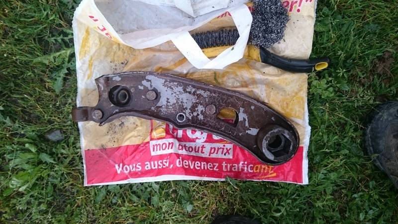

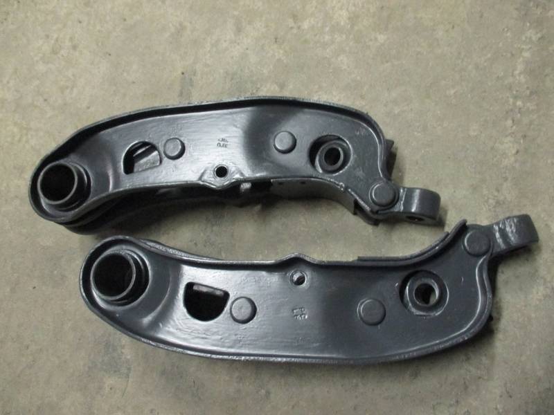

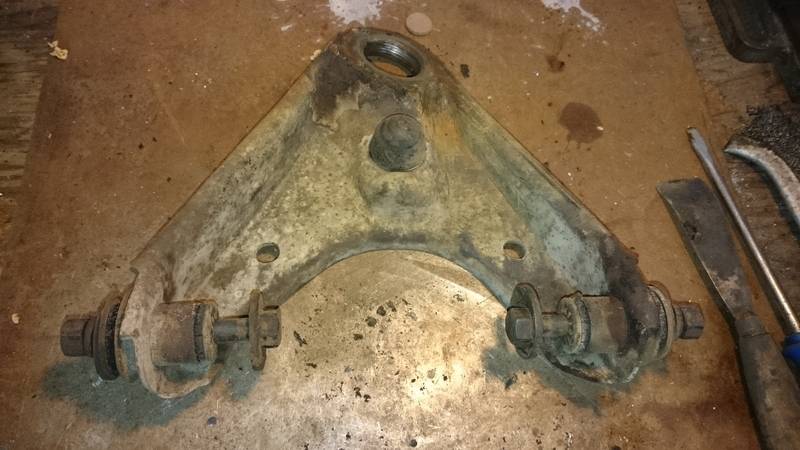

Once I got the shafts out of the LCA's, I decided to try the vinegar trick again. It didn't work on the spindles, but the control arms were only covered with surface rust, so I tried again. I bought the cheapest vinegar I could find, and let them soak for 2 or 3 days. Then I steel brushed them, rinsed them with water and painted them immediately with Hammerite like the other suspension and steering parts. I know the grey is not 'resto correct', but I had some white and black leftovers that I mixed – cheap, and it works.

So, this picture is what they looked like when the came out of the vinegar?
Yep. The rust, grease and grime transformed into some kind of black crusty layer, and I just used the brush and the wire wool you see in the pics. I was really surprised with the results - it was much cheaper/easier/cleaner than sandblasting and still cleaned all the hard to reach areas.

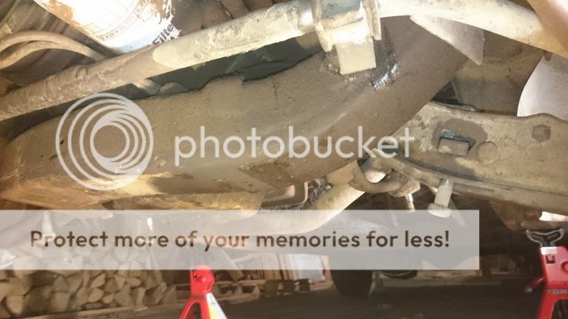

Instead of mounting all those shiny parts back on a dirty chassis, I decided to completely clean the stubframe and engine compartment. Man, what a PITA that was...!!!! It was covered by a thick layer of dirt, grime and grease, mixed together and left to bake for decades. I tried every trick in the book (spirits, solvents, oven degreaser, you name it...) but the only way to get rid of it was to manually scrape it, then clean the remnants with brake cleaner, finished by some heavy pressure washing. Then Rinse and repeat... It took me so many hours I sometimes questioned my own sanity, especially when laying on the cold dusty ground on a cold sunday evening...

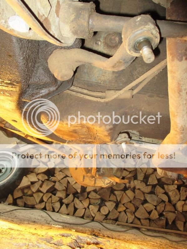

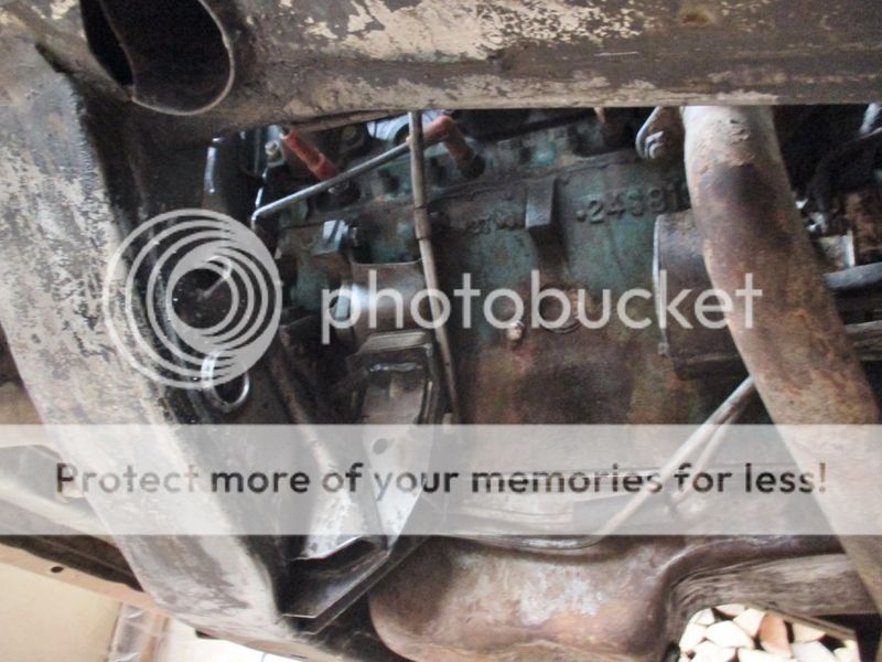

Again, I'm sorry for the really bad quality, but here are a few before and after pictures of the underside of the car for comparison.

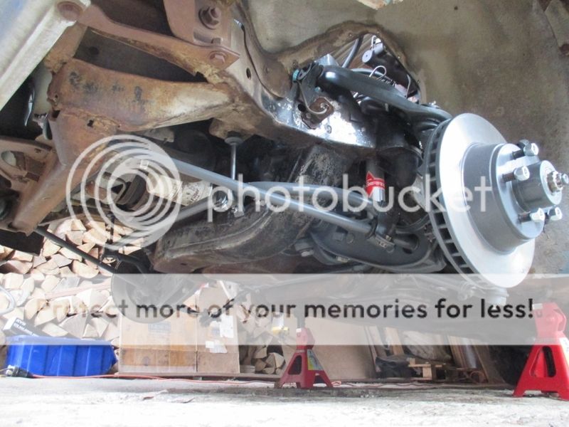

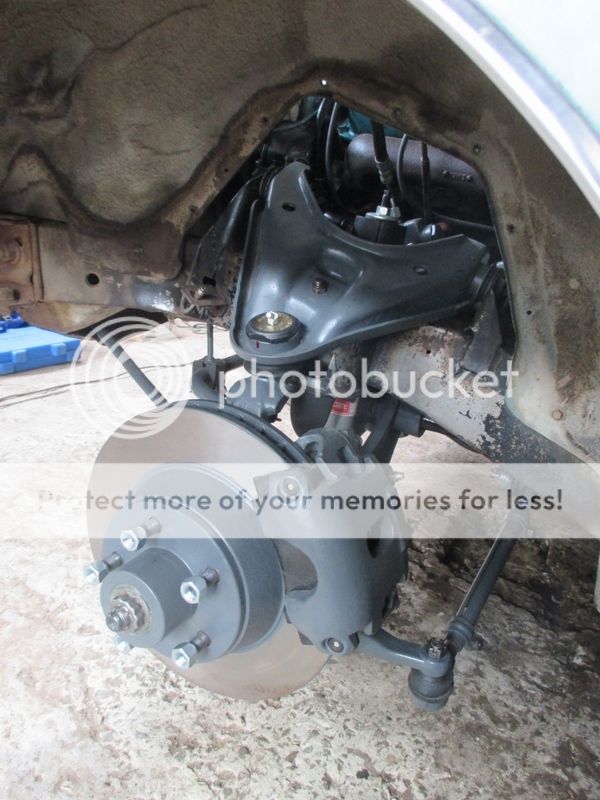

And here's the whole suspension back on the car. The front is now back on the ground (since last week), which brings the thread up to date.
It's only finger tight until I can put the car back on a flat surface.

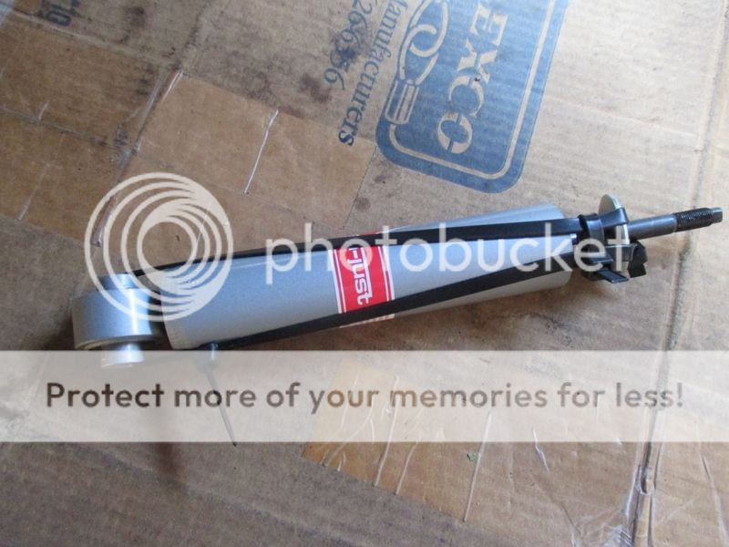

As I see the question popping from time to time, here's what I did to put the shock back into place. I also had to play with the height adjusting screws to be able to put them in.
