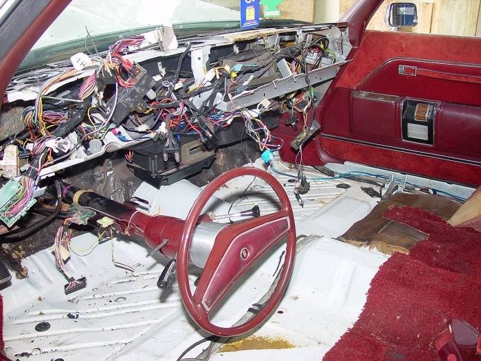

TRANSMISSION : A883 from a 66 Fury.
CAME FROM: Steve Hobby, owner of Mopar Fins.
PEDALS: A Frankenstein hybrid fab of a Formal and Jeep pedals.
WHY THOSE: I examined as many clutch pedal setups as I could find and the Jeep appeared it would be a good match.
To R&R the pedals.Why did the dash have to come apart?
Thanks. Couldn't have been done properly without mocking up the firewall on the bench.I love the pic of the jig set-up for the pedals

I think I would've lost my mind in that mass of wires.Me after the dash...

Agreed, but that is a lot to sit down and take in.You'd think but the FSM makes things a lot easier than they appear .
While the conversion was complete, when I sold it it still had a couple of gremlins under the dash and needed new front seat upholstery from welding sparks. My stupid.How long did you own it after the conversion? How did it drive, were you satisfied with the result?
I actual did. Midway through the dash I was pretty close to selling it to someone who wanted the car for parts.
Also meticulously tagging every wire and connector. Thank gawd I find wiring diagrams intriguing to work with.You'd think but the FSM makes things a lot easier than they appear .
