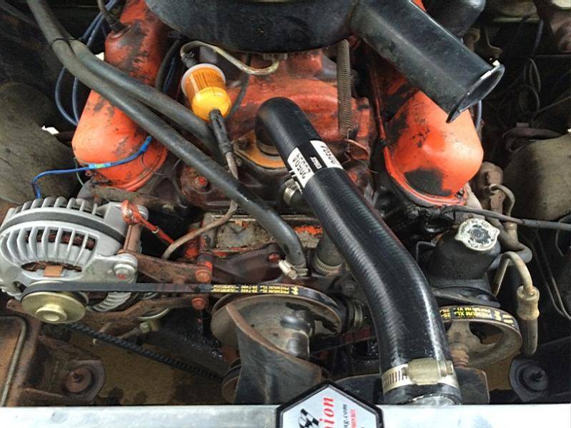

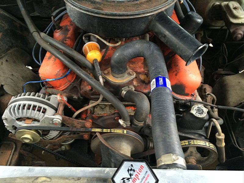

Recently I had the front end rebuilt and the mechanic mentioned I had a hole in the upper radiator hose.
Initial I looked for a 1969 Dodge Polara 318 no AC and there was no hose listed, so I went to the parts store where they will let me look through the hoses.
I find the hose that matched what was on the car and got it. I still wanted to look into the hose issue and looked up the factory part number and keyed it into the various parts store websites and ebay and came up with a different hose that what I just got. A gates hose was ordered, when I received the hose I pulled the other hose and started to put this one on but it basically did not fit. I re-positioned the hose on the radiator and was able to get enough to fit onto the thermostat housing. put the coolant back in and on I went.
Having the Champion radiator actually helped me as the inlet was about 1" closer to the center, I do not think I could get this hose on with the factory radiator.
The first hose was a ECR/NAPA 7365
The second one is a Gates 20594
Not sure what to say, get the other hose?
Alan
