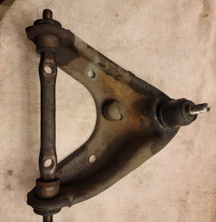

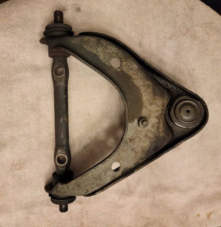

As I mention elsewhere, I bought a hot rod with a (supposedly) 69 Fury iii front suspension. I need to replace the upper control arm bushings prior to taking this vehicle on about a 6000 mile road trip.
The builder is deceased.
The Napa part # 12227 bushing which fits fury iii is not correct.
I have the Napa #12353 bushing which barely fits over the cross bolt ( OD 0.59) and has an outer shell OD of 1.36.
The bushing in the control arm has an outer shell OD is showing 1. 42
The Napa #10162 upper ball joint did fit.
So what the heck is this control arm off of?
I need get these rebuilt in order to get the alinement correct before I can leave. Thanks.

As I mentioned, the Napa ball joint #10162 ball joint did fit. ( although the socket was not to be found. I took the smaller socket and a rotary cutting bit and opened up the smaller socket to make it fit) New ball joint on the left, old one on the right.

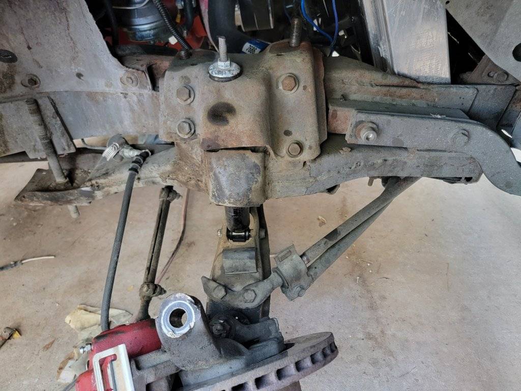

That control arm looks like the ones that were on my 1979 Aspen. IF I am correct, I would think that car would have the transverse torsion bars too....
Do you have any more photos?

Yeah that's the Mopar FMJ suspension and K frame. Pretty popular swap for hot rods I was told.
Ask for parts for a 1978 Lebaron and you'll get everything ya need.

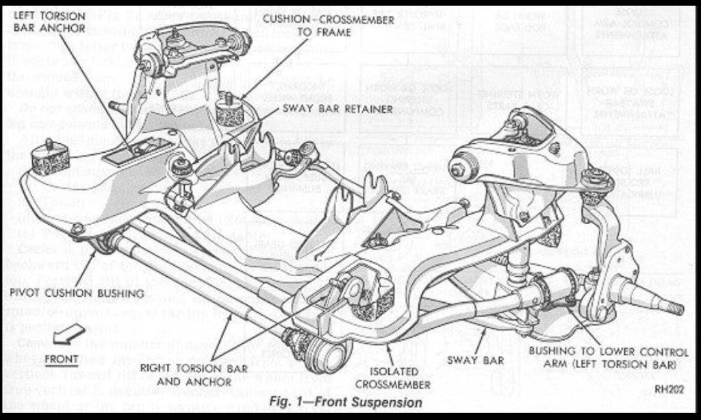

I'm going to have to correct you guys on this one.
No question about it, that's an isolated K member used in the 1973 and up B bodies, Cordoba/Charger to 1979, and R bodies up to 1981.
The FMJ has transverse torsion bars that connect to the outboard area of the lower control arm.
They all use the same upper ball joint, but the upper control arm bushings only fit the B/R bodies.
Jeff
That there be the strut and sway stopper.
The torsion bar be the one what's in the back on the left under the frame.
