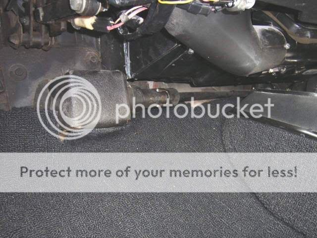

How were the mechanicals done? Was the steering box swapped side to side?
I saw a Charger once that had a chain system under the dash and even though it was done well, I thought it was kind of Mickey Mouse.

As for the conversion in the old (early) day yes chain system under the dash and lot of other mickey mouse thing. But these day everything is change over from left to right. can cost around $20k
Yes, he scrounged parts from a lot of scrap yard Dodge Phoenix Fuseys for his conversion...no chains.
I came across this picture of a right hand drive conversion. Interesting....
