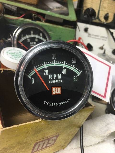

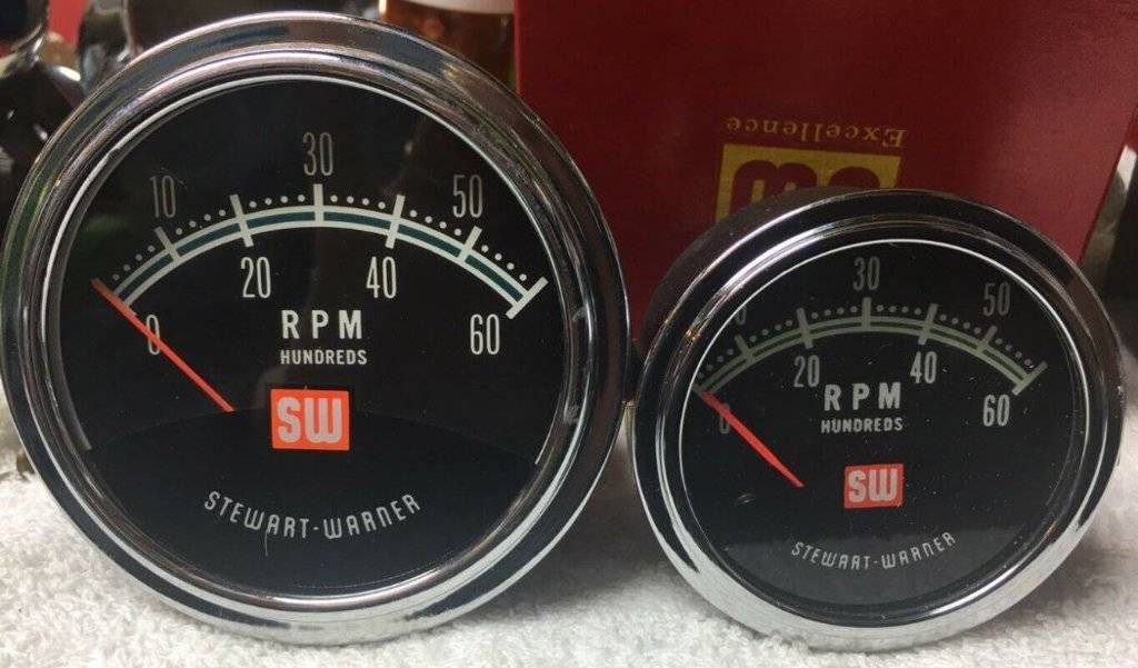

Have the opportunity to get one of these. I mocked up the larger version, (3 3/8"), on my steering column. Think it's too big. Probably go with the compact series, (2 5/8"). My gauges are all new SW Greenline, so want a similar tach. The new SW GL tachs are way too long in my opinion. I'm going with some little 'period correct' options that I think owners back in the day may have made. Thoughts? Thanks!

This is the smaller, 2-5/8" compact series. Pics...….

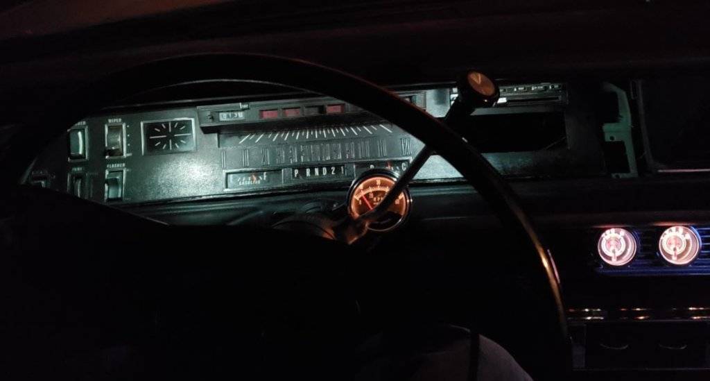

On vacation again, had some time to get all gauges installed/working, got dash lights to work finally. Bypassing the dimmer switch, but hell, lights are not bright enough to dim anyway, so coming off a 12v source when headlights go on.

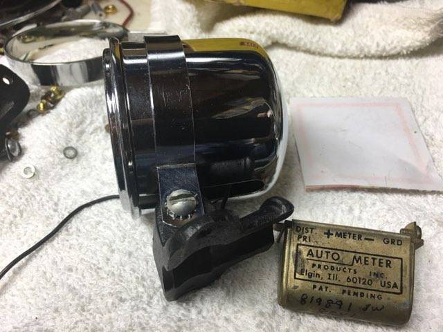

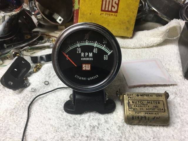

Old school SW GL tach installed/running. This is the old school style tach where you have to install a sender/transmitter. It's the 'mini' size tach, not made anymore. SW only makes the new, larger GL tach, which doesn't work for me. Warm idle looks to be just under 600. I included some video. I love how the SW temp gauge goes 190ish, then thermostat opens, and temp goes down. Can see it towards end of video.
