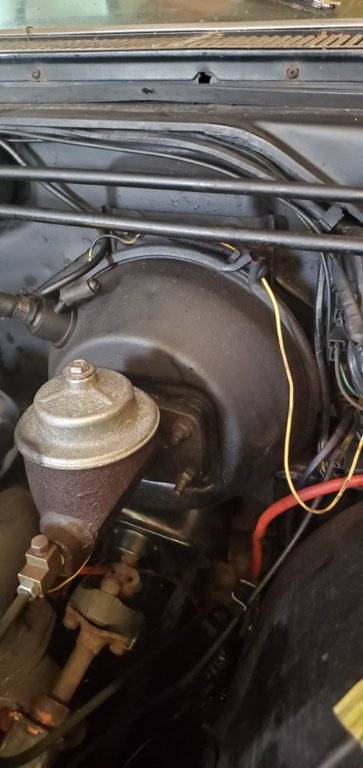

Wondering if I can swap out this single res to a dual res master cylinder- drums all around, while keeping the original booster?
And if I can, which one is suggested?
Thx in advance- not getting much reliably in my searches...
If you are sticking with drum brakes all around, you can keep that booster and swap masters. One for a 1967 C-body will work fine.
On the new MC, plumb the front outlet to the rear brakes. You can use a short piece of line with a union. Plumb the rear outlet into your existing distribution block, and plug the unused port on the block. There are also cleaner looking but more expensive plumbing solutions which involve replacing your distribution block.
A lot of people will tell you to not do it. I did and have had no problems.

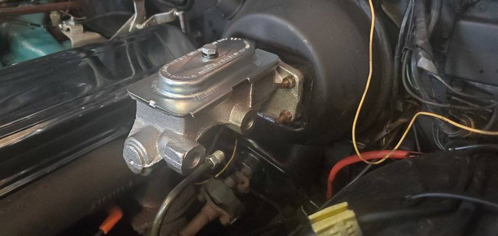

That is a disc brake MC. It does not have a residual pressure valve on the front circuit, which is needed for drums. Or else you swapped to discs but kept the drum booster. I did that before and my original 383 produced JUST enough vacuum to make the brakes work. Then I swapped-in my 451 which did not, and it was definitely dangerous, so I had to install a proper disc booster. So either way, don't do what you have done. :p
Didn't take long....
Yes, I swapped to disks. Yes, it's been 12 years. No, I have had no problems.

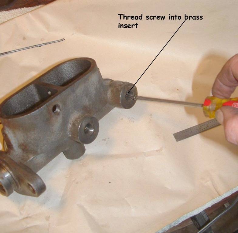

Thread a screw into the hole and carefully pry the seat insert out with some pliers.

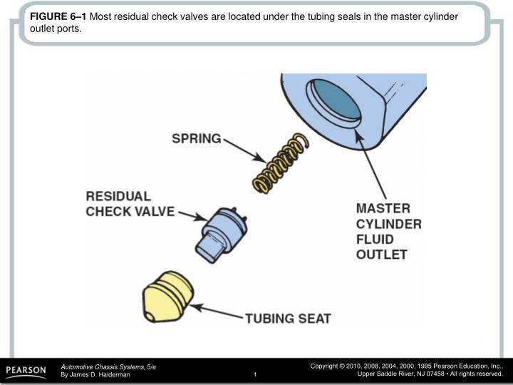

The RP valve installs like so:

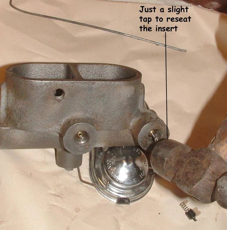

Then reinstall the brass insert and remove the screw. (In the following pic there is another RP valve sitting on the bench so you can see what they look like.) When you install the Weatherhead adapter I mentioned before, it will finish pressing the brass insert the rest of the way back into place. Just go slowly to make sure the insert is not in there cocked.
(Disclaimer: I stole all these pics for this how-to from other websites.)
