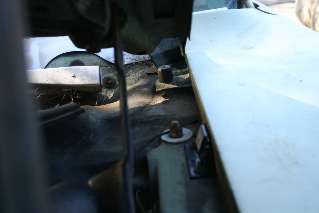

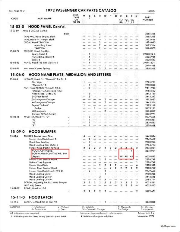

My 72 has a threaded hole in the center of the cowl for the bumper, the plastic cover has a hole as well, there was no bumper when I purchased the car but a lot of original parts were missing.
Here's a photo showing the provision for the bumper.
Might've been to reduce hood flex/fluttering at highway speed, which could be visible to the driver.
But would be odd to have that on just 1 model of car (I say that due to not being used apparently on any prior cars?)
