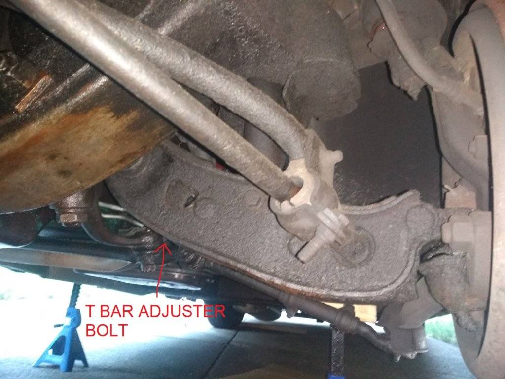

1. With the weight off the front wheels, unload the torsion bars by loosening the adjuster bolts that stick out of the bottom of the lower control arms. (In my picture the bolts are already out, but they should be where the red arrow is) Make a note of how many turns you loosen, so you can put them back about the same. They will need to be adjusted to check your ride height when it goes back together.

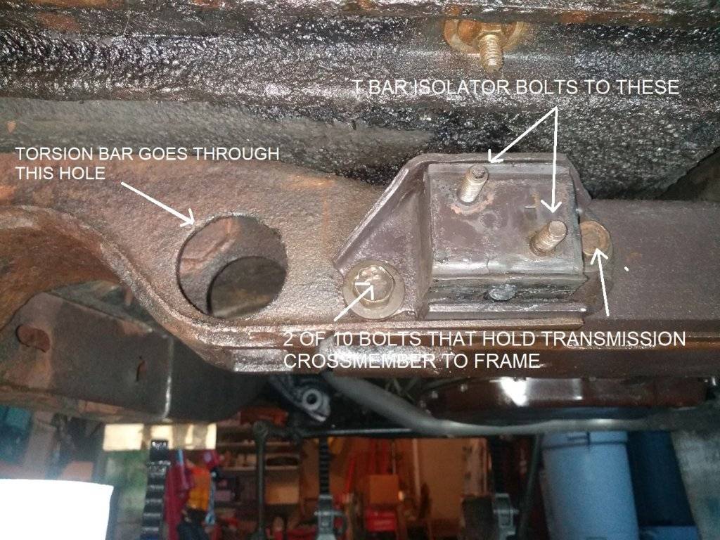

2. Remove the isolated torsion bar crossmember. This is found only on Dodge & Chrysler in 1965. It goes across the rear of the front stub frame just behind the crossmember that holds the tranmision mount.
There are 2 nuts on each side that hold the isolator crossmember to the frame. Once those are removed, you should be able to pull the isolator crossmember to the rear. Either the torsion bars will stay in the control arms and the crossmember will come off without them, or they will come loose from the control arms and stay attached to the crossmember. Either is ok, but things get more unwieldy if the T bars stay in the crossmember. If the bars come out of the crossmember, you will have to reseat the seal that goes around the end of the torsion bar.

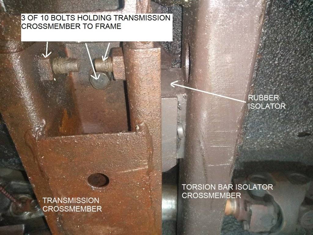

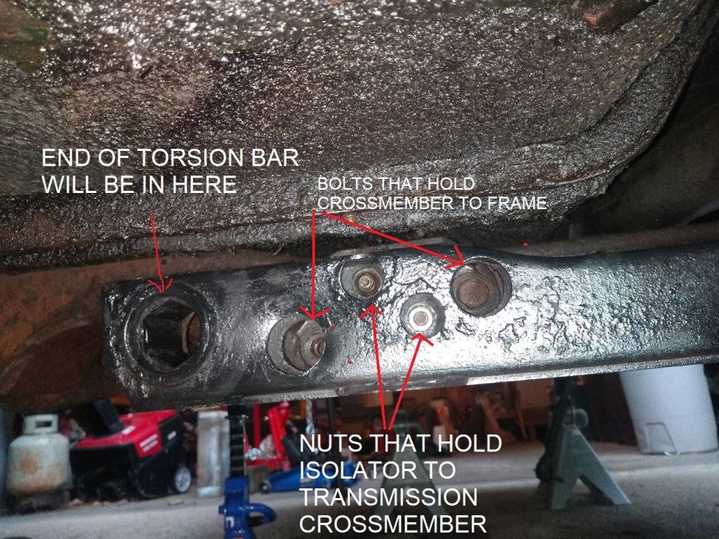

3. Once the isolator is off, you can unbolt the transmission crossmember. There are 2 bolts on each side that go through the rubber isolator blocks, the transmission crossmember & into the frame. There are 2 more bolts on each side that are opposite the rubber block bolts, and then 1 on each side that go vertically up through the crossmember into the frame.
Try not to damage the transmission mount as that is a 1965 only part, so hard to find and expensive.

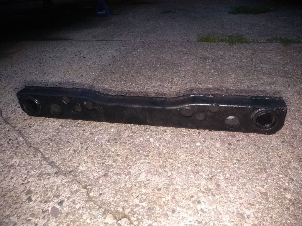

Here is where I stand. Today has been an absolute f-ing nightmare! Things started well, I unloaded the torsion bars, one was easy the other I don’t want to talk about. Then it came time to remove the cross member, it came out very easy. Ok now it is time to move back the trans, we pulled back the trans and to my surprise the f-ing flex plate dropped out of the bell housing on my head along with six screws (5 in okay shape and one severed half way). I have no idea how I was able to drive this car home. So now I have to drop the tranny not just move it back. While trying to lower it I realize the headers are in the way so I disconnect the headers for the room needed. Now I’m excited and try to lower it again and it gets caught up on the starter, (major pain in the balls, because it is already halfway dropped). I get it about 4” from the ground and notice that the dipstick won’t let me go down.
