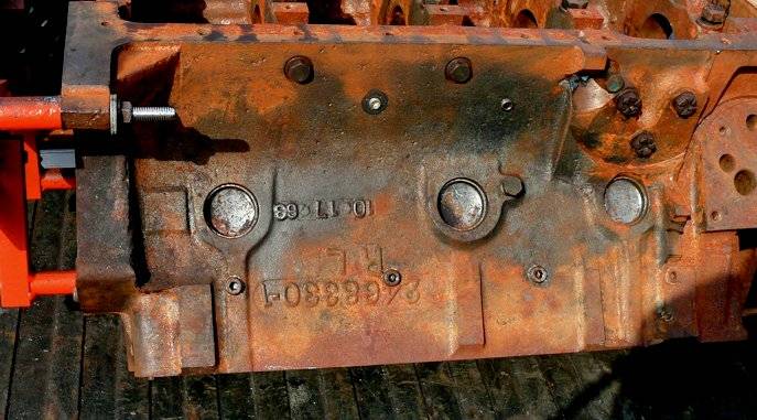

You can also look at the engine casting date on the drivers side of the block. There will be a casting number just below the freeze plugs #2536030 from '67-'75. (318 engine) Just below the casting number is a casting date which give the month, day and year the block was cast. Model year production usually ended in about June and then the plants were retooled for the new model year. Most engines produced early in the production cycle will show, for example, a Sept '70 production date for a '71 model car. Engine casting date should always be before the build date of the car.
Dave
Here is an example of a mopar block and date casting number from a big block, the same pattern was used on most mopar engines.
Dave
Hi Dave, thanks for the reply. I can see on your engine clear as day that it was built in '68. Any idea on the number I found on my engine (behind the power steering pump)-M318R 06 131947??
Dave
That's not just a big block, that's a 426 hemi! Small block casting dates (at least the early ones) are located on right front near motor mount, here's a 273 for example. It will be hard to see in car. BTW, still think you should bite the bullet & just get a good replacement cover. Do realize shipping costs to MX can be outrageous.

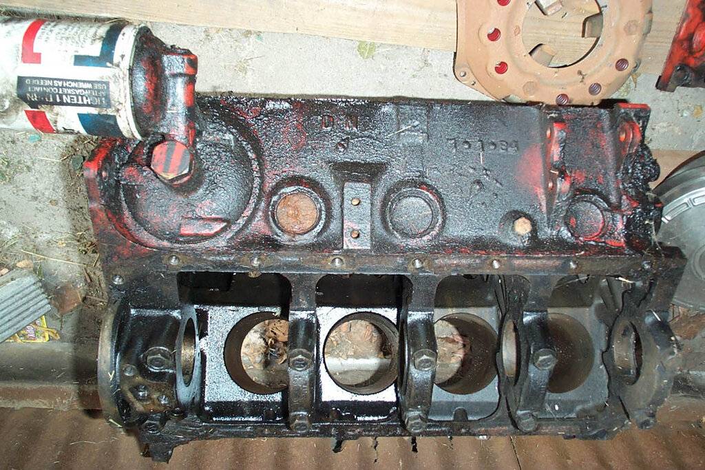

Here
is a 318, casting number and date are visible on the driver side of the engine.
Dave
