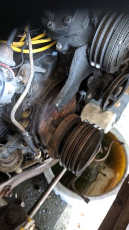

About your A/C, we don't see a picture or know what kind of service has been done other than your description that: "working very nicely," so from what I see of all the engine grime I would doubt much, so moving your compressor should be minimal with just enough to get at your work at hand. When you start moving old A/C lines who know what can happen if they are aged, crack a tube, or crack the old rubber and seals, move it too much and you maybe doing more than just recharging your system. You may want to make a quick 2x4 wooden frame to wire/hold it up just a little so you don't stress the lines.
Also replace your upper & lower radiator hoses, from the amount of grime I see on them they are doomed to fail. Same for the heater hoses & nipples, that one bolt can be removed with a open end wrench fairly quickly. As far as the nipples go post up a pic and we'll see, but your right in there and they still are available and I would think not that expensive, so... Also I use a Oxy-Acetylene torch to heat up the cast iron at the base of the threads, easiest way to get them out without damaging them. Heat and spin them right out, don't beat yourself up on them.
I vote for taking the radiator out (I learned that one the hard way)
Naturally, I have no plans to leave those hoses in place. Of course, they are not original to the car, but they have been on there for some time. I think I replaced them when I first got the car about 15 years ago. I will be cleaning as much caked up oil and grease as I can along the way, and re-painting all the components I remove (leaving the gasket surfaces bare, of course).
Literally nothing has been done to this engine outside of some ignition upgrades, a carburetor rebuild, and some exhaust and cooling system work. I converted the A/C system to 134a about 5 years ago, and it works well, so I don't want to disturb it. I certainly plan to support the compressor so it is not exerting any undue pressure on the lines.
The radiator is absolutely coming out. All the antifreeze is drained, I'm replacing the hoses anyway, and it's only held in by a couple of bolts, so it's definitely being removed. Besides, I want to be able to get an impact gun in there for the pulley bolts, so I will need all the room I can get.

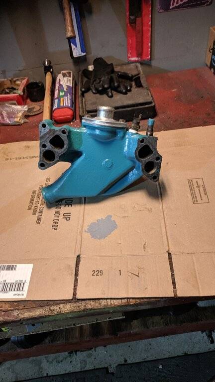

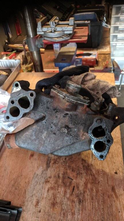

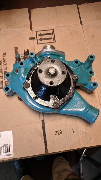

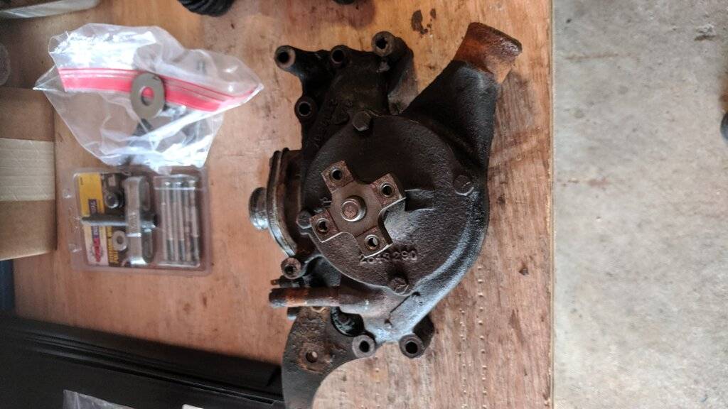

A bit more work was done today. The pump housing gave way easily when the "hidden" bolt behind the heater hose fitting was backed out.
This will all get cleaned up and refinished as things go along.

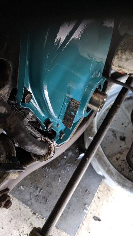

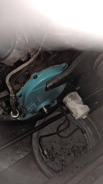

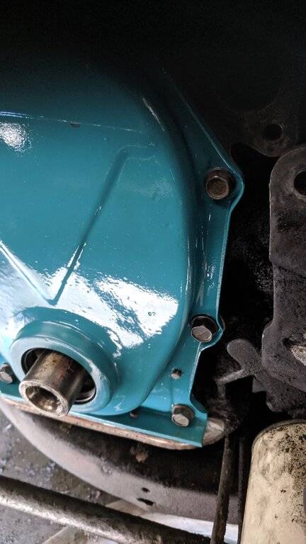

The timing cover didn't want to line up when the new lower gasket was installed. I tried installing the lower bolts first to compress it, but it was of no use. I had a roll of gasket paper that was thinner than the cork in the Fel-Pro kit, made another gasket out of it, and everything went together as it should.
I will continue to wipe things down and put finishing touches on various components as things progress.

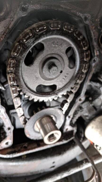

The old set didn't have a nylon covered cam gear, which was the whole reason I dove into this in the first place, but the chain had relaxed a fair bit. It was deflecting about 1/2". The new chain is nice and taut.
Looks like you got the pipe fitting out of the water pump housing, nice work.
You lucked out with a top sprocket made out of metal, maybe it has been changed already in the past, I hope who ever did the job checked the oil pickup screen for debris, but maybe the (if it had) nylon sprocket wasn't all tore up and there was no need to check the screen. The lower pan timing cover 'kit' gasket should squash down and if it doesn't after being compressed for 24 hrs a loosening and re-tightening of the bolts may help bring it down. It does help to loosen pretty much all the oil pan bolts and 'crack it' so to say, this will work on a factory installed oil pan gasket but if someones been in there and coated both sides of the gasket with permatex gasket adhesive you may tear the gasket (or have to use a chisel to beak it apart) but then a tube of your fav wiz-bang sealant can come to the rescue!

As far as the cork gasket is concerned, there's absolutely no way it was going to get squeezed in there and still have the timing cover line up with the alignment pins. I mean, there was NO chance of that happening. I would have most definitely had to loosen the entire pan to make that gasket work, and even then, I would be concerned about irregularities popping up along one of the sealing surfaces that would get disturbed by that method. The far easier solution was to use the paper that I had, which was a little more than half the thickness of the cork gasket.
I did run into one problem, but I'm not too sure how serious it's going to be. When I was tightening the last of the bolts in the lower right hand corner, the fabricated gasket began to walk out from beneath the timing cover in that area. It separated from the block about 1/8", but ONLY at the tip of that one corner. It did not move out from the area where the bolts actually are, or migrate in or out from the main sealing surface between the oil pan and the timing cover. It also didn't split anywhere as far as I can tell.
I put a dab of sealant in that 1/8" gap, but will this be sufficient? I have no problem taking the cover off of this motor, fabricating a new gasket for that spot, and putting everything back together again. The last thing I want is to put it all back together and have it leak.

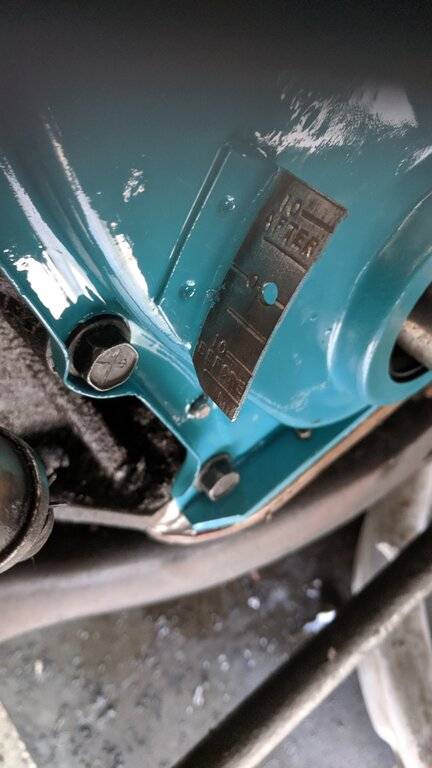

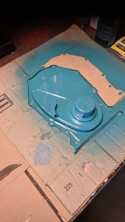

I'm not quite sure what you mean by "walk out" did the gasket shift or get squeezed out? From looking at the picture of the freshly painted timing cover I can see white stuff around the outer edges, I hope that isn't silicone sealer, silicone is slippery before it hardens and can cause gasket to shift/slide/squeeze out. Always use a tacky gasket adhesive and proper torque on bolts. A close up picture would help.
Nice job painting the cover... to bad you missed the bolts :poke: not hard to do, just put the bolts into a old soup can, blast a healthy shot of carb cleaner on them, rattle them around for a minute and dump them out on a shop towel, let them air dry or give them a blast from the shop air gun. Grab some cardboard and punch a bunch of holes in it, stick bolts in holes and rattle can away. The heads will get a little socket roached unless you let the paint harden for 30 days, or bake the paint, but it will look a lot better than greasy black bolts like you have now.
Also replace that fuel line section(s), it's all wide open right now and your right in there.
The bolts were de-greased, but not painted. What you're looking at is my greasy fingerprints all over the bolts and the cover. I'll clean everything off before I bury it all under the pump housing and other parts.
"Walking out" means that as the one bolt was tightened, the gasket slid away from the corner 1/8" (but no other portion of it moved). I think, in the end, I'll be doing that over again instead of wondering whether or not it's going to leak, unless it's not likely to be a problem.

I couldn't help myself, so I replaced the gasket again, and re-painted the timing cover. This time, it all went like clockwork.
I also gave the bolts a good scrubbing. I left them unpainted because I actually like the way it looks.

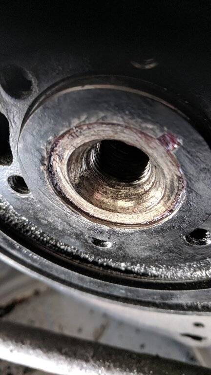

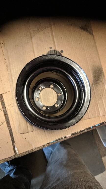

The pulley was also repainted (but not the grooves...just the body of the pulley), along with the balancer (with care taken not to get paint inside the hole for the crank snout).
I am guessing the balancer is all the way on. I never really felt it 'bottom out', so to speak, but it won't go further without spinning the motor. I used a long piece of 3/4"-16 threaded rod, a nut, and a very thick washer to reinstall it.
The torque spec for the harmonic balancer is 135 ft lbs if I am not mistaken. The engine will start turning over long before you reach that value so you need to block the crank somehow. The way I did it was to put a socket on one of the flex plate bolts so it would lock against the engine block. If the balancer isn't fully seated yet torqueing it down will make sure of that.
