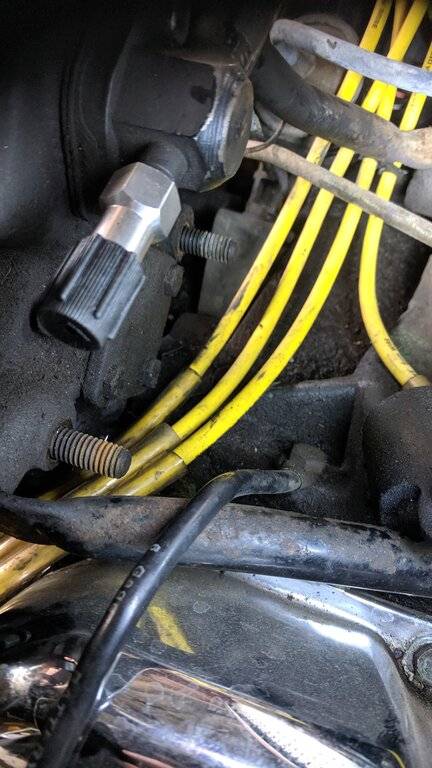

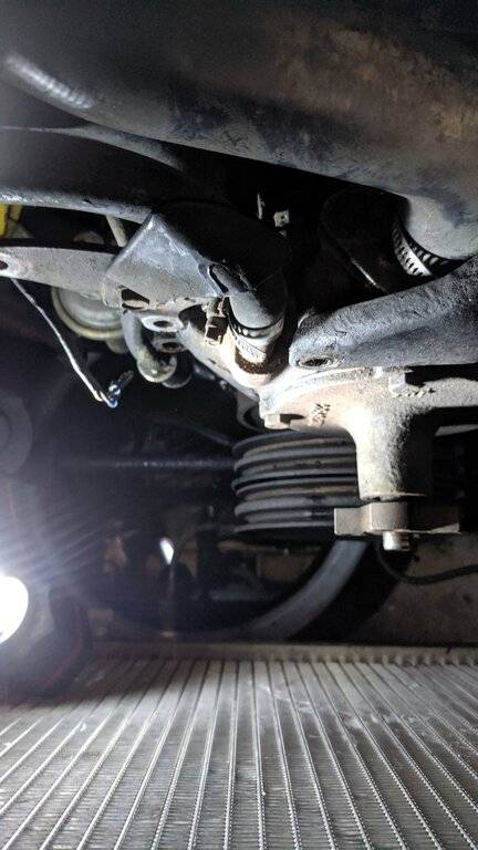

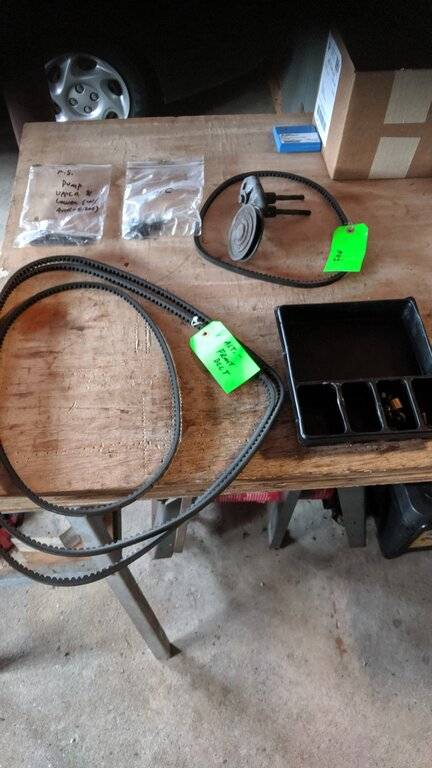

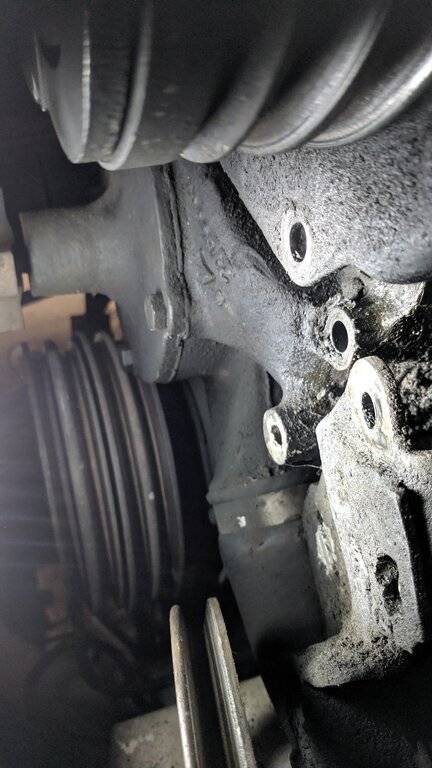

Here are some photos of the process. My guess is that only the top two bolts remain; one behind the heater hose fitting, and one that is shrouded by the A/C support bracket.
I'll be taking this opportunity to clean and paint some of the components. This engine has never been apart for any reason, so there's no shortage of grime and grease on most everything.

About your A/C, we don't see a picture or know what kind of service has been done other than your description that: "working very nicely," so from what I see of all the engine grime I would doubt much, so moving your compressor should be minimal with just enough to get at your work at hand. When you start moving old A/C lines who know what can happen if they are aged, crack a tube, or crack the old rubber and seals, move it too much and you maybe doing more than just recharging your system. You may want to make a quick 2x4 wooden frame to wire/hold it up just a little so you don't stress the lines.
Also replace your upper & lower radiator hoses, from the amount of grime I see on them they are doomed to fail. Same for the heater hoses & nipples, that one bolt can be removed with a open end wrench fairly quickly. As far as the nipples go post up a pic and we'll see, but your right in there and they still are available and I would think not that expensive, so... Also I use a Oxy-Acetylene torch to heat up the cast iron at the base of the threads, easiest way to get them out without damaging them. Heat and spin them right out, don't beat yourself up on them.
I vote for taking the radiator out (I learned that one the hard way)
