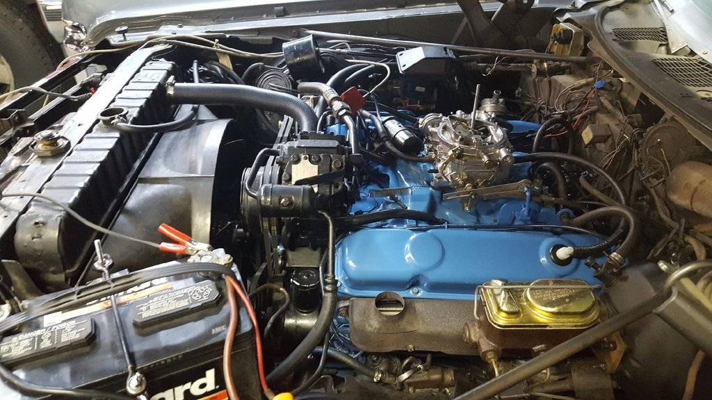

Is it possible the timing marks should be be top / top?
When disassembly on my 440 the marks were as mentioned above. When reassembly, I followed the book and set the timing at top / bottom.
Car will crank, it's getting fuel and spark but it is too far advanced. It backfires through the intake/carb.
Any thoughts on this?
