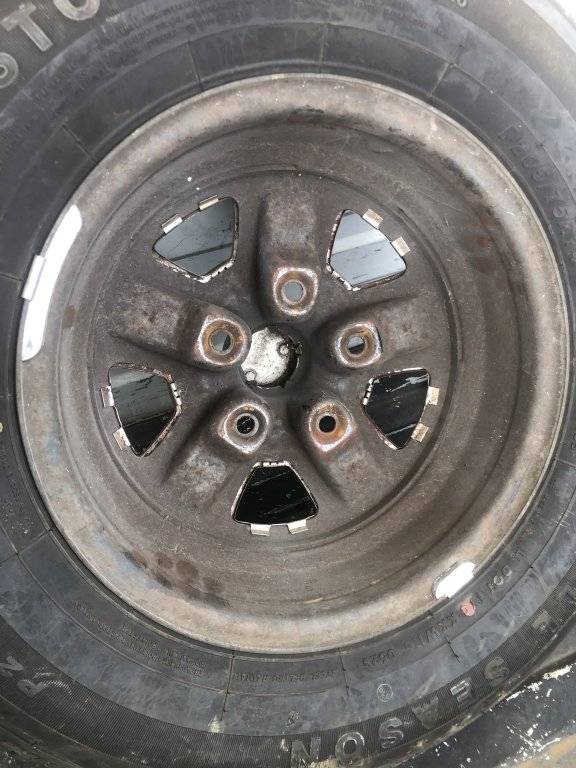

**EDIT** Now that your pix have loaded, to me it does look like they pulled off one big weight and then split it into two different locations, although maybe the total is even more weight???
They did not remove the the first two weights that they had put on when mounting the tire originally. I noted where they were before they took it in to balance it. The same weights were still on it in the same places when they brought it back out. Plus two more in different areas as seen in the pictures.
My question was/is is that the way to balance a tire? Just keep adding weights to it, chasing it round and round?

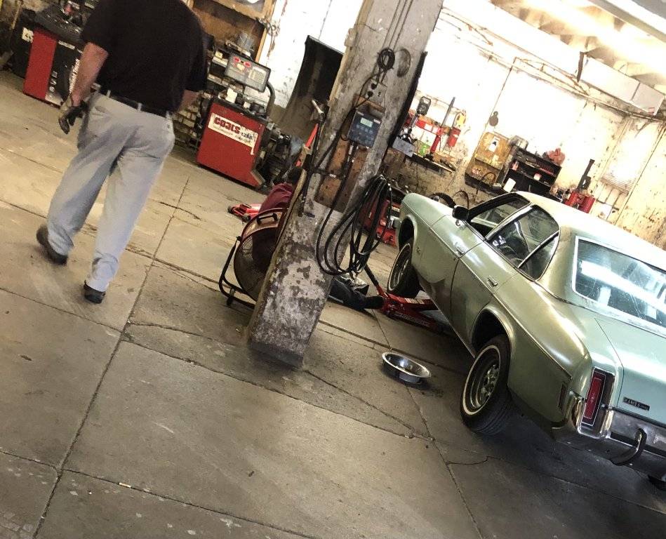

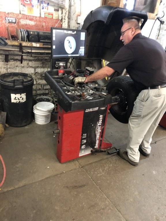

I bought new tires for my 73 Olds a while back and since then it has a vibration about 60 mph.
I suspected an out of balance tire as it didn’t do it with another set I had on it.
I took the one I suspected off (right rear) and took it to the tire shop where I got the tires and asked them to check it. Here’s what they done…
Instead of removing the weights they put on originally, they just added more. In a different area. To me that’s not the way it should be done. Thoughts? I haven’t tried it out yet to see if that helps it.
All previous weights should be removed and re balanced. I used to mount and balance for a living. I experimented on my own stuff. I put a pair of weights on. Then balanced it. Shook at about 50 mph. Removed all the weights and re balanced. Smooth after that. Also check the production date of the tire. If you got the 4 for 3 deal. They slip an outdated tire into the mix.

Conclusion: I Took it over to the tire shop and had a talk with the owner. He agreed that adding weights like they did wasn’t the correct way to do it. I pulled the car in and he conducted a class on how to balance tires right. They were all out a little…some more than others.
He said the real issue was that they were using the wrong cone to secure the wheel to the machine. These Rallye wheels have a odd shaped pattern of spokes that take a different cone than they had previously used.
