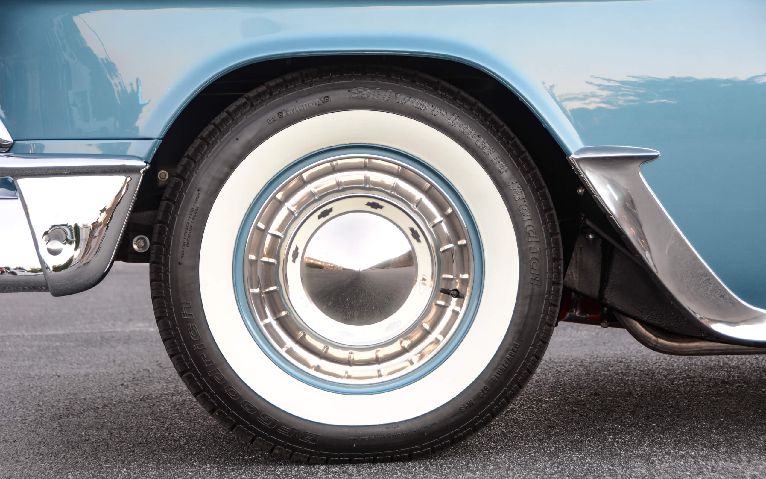

Tire Size 101
The evolution of tire sizing
There are three common types of tire sizing from the 1920s through the modern era: numeric, alphanumeric and P-metric. Uncommon forms of tire sizing are used for high-pressure tires (Brass Era), racing tires, vintage metric tires and certain types of off-road truck tires. Let’s cover the three most common tire sizing styles.
Numeric sizing is most common on bias-ply tires manufactured from the late 1920s through the late 1960s. This started with the tires that were marketed as Balloon tires, due to their lower air pressure and soft ride, compared to the earlier high-pressure tires of the 1900s and 1910s. Numeric sizing leads off with the tire’s approximate section width, listed in inches, and then features the rim diameter (ex. 6.70-15 or 8.00-14).
From the 1930s onward, American cars gradually transitioned into smaller wheel diameters, while increasing tire and wheel width. Any tire size that ends with a zero, such as 6.70-15 or 7.10-15, featured an approximately 90% aspect ratio. Any bias-ply tire ending in the number five, such as 6.95-14, 7.75-15, etc., featured an 80% to 84% aspect ratio. We continue to use numeric sizing in most of our bias-ply tires, as well as our bias-look radials. For radial tires, we simply add the letter “R” in place of the hyphen (ex. 6.70R15).
Alphanumeric sizing became common in 1967 and was the industry standard only a few years later. This type of sizing takes the guess work out of the aspect ratio, but it creates some guess work on the tire’s overall width. The size starts with a letter, which is the tire’s load range. The higher the letter, the larger the tire. A78-13 is an example of a very small tire for an economy car, and L78-15 is an example of a large tire for a Cadillac. The two-digit number after the load range rating is the aspect ratio. The introduction of alphanumeric tires also saw the introduction of smaller aspect ratios, and shorter sidewalls. The 78 series was common, but 70 series and 60 series came shortly after.
The muscle car era saw creative usage of alphanumeric tires, including the Firestone Wide Oval. It was available in redline originally and then later in raised white letter. Popular sizes for the Firestone Wide Oval included F70-14 and G70-15. Aftermarket tire companies, such as Pro Trac tires, offered custom alphanumeric sizes, such as N50-15, an enormous tire that was typically used on the back of modified muscle cars. Radial tires were introduced to American markets in the late 1960s and became original equipment offerings in the mid-1970s. The alphanumeric sizing remained for a short while, but an “R” was added after the load rating (ex. LR78-15).
The most current form of tire sizing is P-Metric. This sizing nomenclature can be confusing because the section width is listed in millimeters, the aspect ratio is listed as a percentage, and the wheel diameter is most often listed in inches. For example, a P205/75R15 tire features a section width of 205 millimeters and a sidewall that is 75% of that width. The “R” tells us it’s a radial, and the 15 indicates a 15-inch wheel diameter. This has been the industry standard in the United States since the 1970s, but the idea for this metric size came a couple decades earlier in Europe. British sports cars featured tires such as 165R15, dating back to the 1950s and 1960s. You’ll notice that there is no aspect ratio designation in this example. When a size is listed with only the section width and rim diameter, you are to assume that it features an 80% aspect ratio.
P-Metric radial tires are a common replacement for original bias-ply tires. In the case of 1950s classics, we most often suggest a 205/75R15 for cars that originally came with a 6.70-15 bias-ply tire. We also use 205/75R15 radials as a cross reference to original 7.75-15 Corvette tires.
