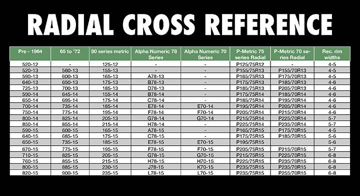

My 61 Fury came with 850 X 14 tires originally. I'm stepping up to 15" motor wheel spoke wheels. Does anyone know what 15" tire size will compare to a 850 X 14 tire dimension?
Thanks
Will.
For future reference for anyone who comes across this thread:
215/70/15 is very close
That is the same size I put on the Monaco. It was the closest size with a decent w.w. and cost much less than Cokers or Diamond Backs.
Originals on the car were 8.55x14
