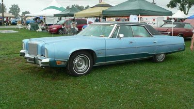

hi what size tires are u guys running on your new yorkers
just getting ideas

Firestone 235-75R15 with the 1" whitewall on the '78 NYBS. They've been on there since 2010. I've had very good luck with them, and the ride quality is pretty good.
I checked on the Firestone website, and it doesn't appear they offer that size in a whitewall anymore. I was hoping they might still make them too.
