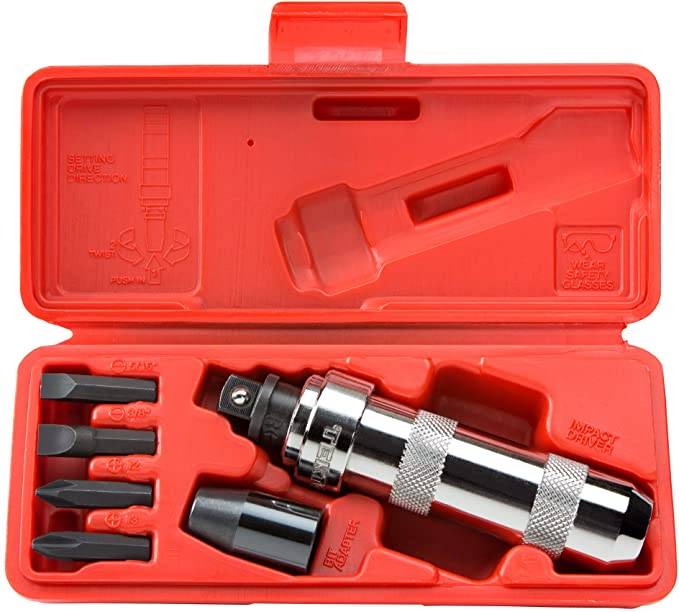

I've always used an impact driver for stuck fasteners.
I bought that exact set several years ago when I needed to remove the chrome strip in the front edge of a 65 Newport. I think 8-10 screws. 3-4 came out with a phillips the others I used this tool. First two it did extremely well then it got dull. Had to drill the remaining out. I’ve used up all 4 sizes now & it’s not much good unless it’s a newer soft screw. It might work on the 81 Imperial I have to strip as I’m sure those are soft fasteners

$50.00 for a used one?
$20 for a new one?
I bought that exact set several years ago... First two it did extremely well then it got dull. Had to drill the remaining out.
Well, sure, they get dull just like any drill bit or chainsaw. I wonder if the cobalt version is tougher than the titanium. Anyway, $20 gets you a new set. Just think of all the money you'll make by gently removing those unobtanium trim pieces! :thumbsup:
