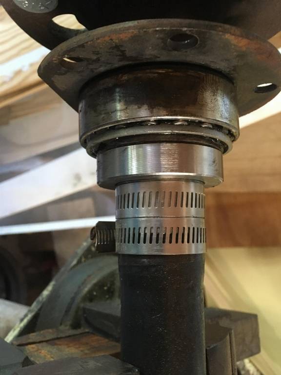

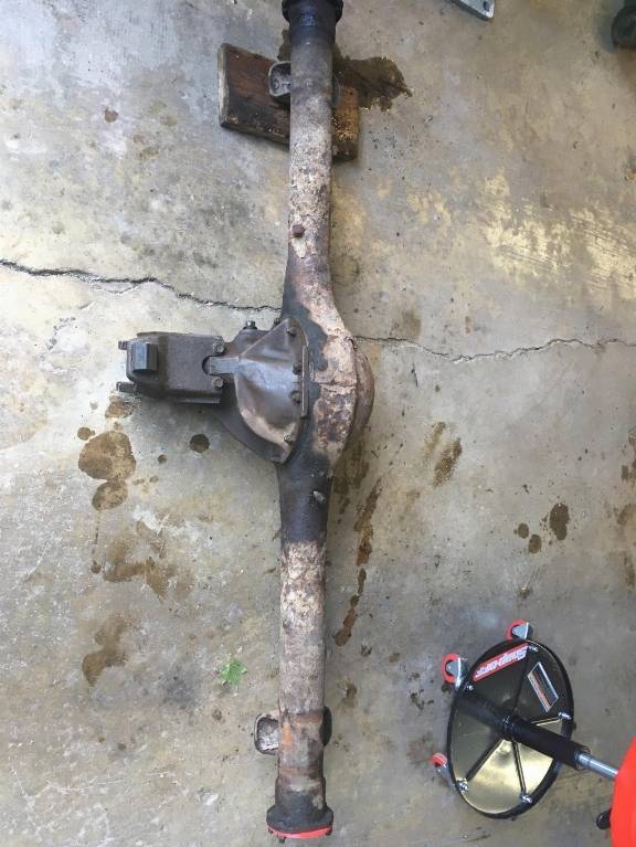

I started this job today... I want to change the rear axle bearings and was looking for a good way to protect the seal areas on the axle while I take a cut off disk to the bearing and retainer. .
I came up with this... 2 hose clamps.

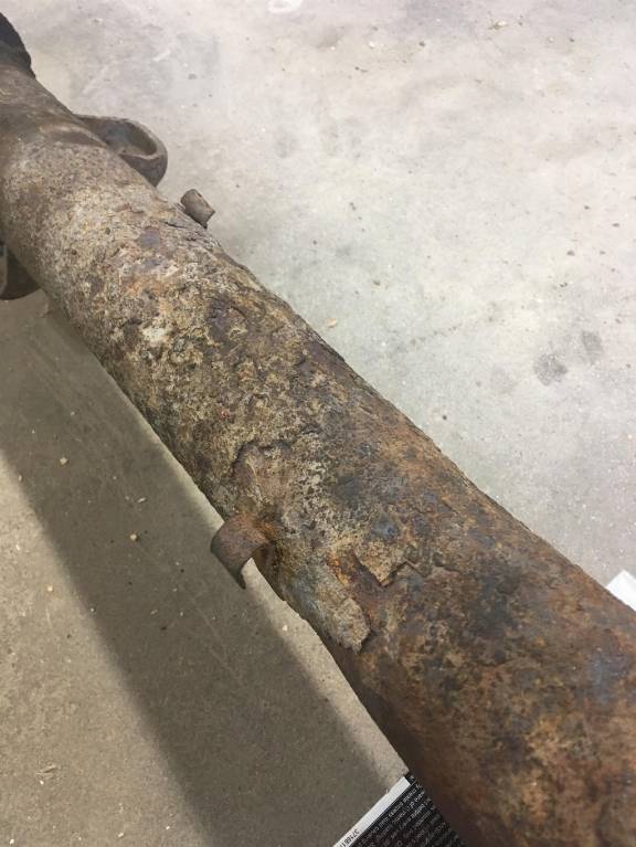

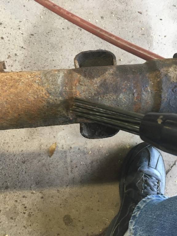

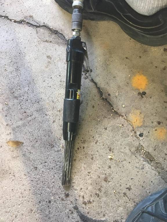

I started using a needle scaler a while back. This is one of those tools that I've only ever seen one other guy use, and that was on a cruise ship. One of the crew was repairing a railing and using the scaler to clean up the area.
These aren't made for use on sheet metal, but it works great on things like this rear end. It knocks the heavy scale off and generally cleans up the area. Using a wire wheel does the same, but there's no flying wire bits or a big cloud of dust. I knock all the scale off with the scaler and then finish it with a cup wire wheel in my angle grinder. It's probably the same amount of time, maybe a little less to do it this way. It does save the mess though.
They have a couple different models at Harbor Freight.
Compact Air Needle Scaler

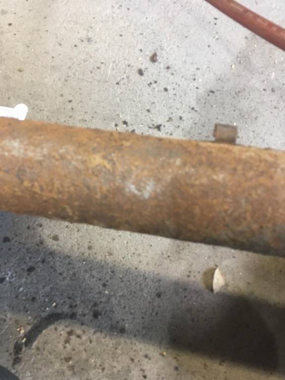

I didn't get a good pic, but you get the idea... The big hunks of scale and rust are chipped off and ready for a few minutes with the wire wheel.

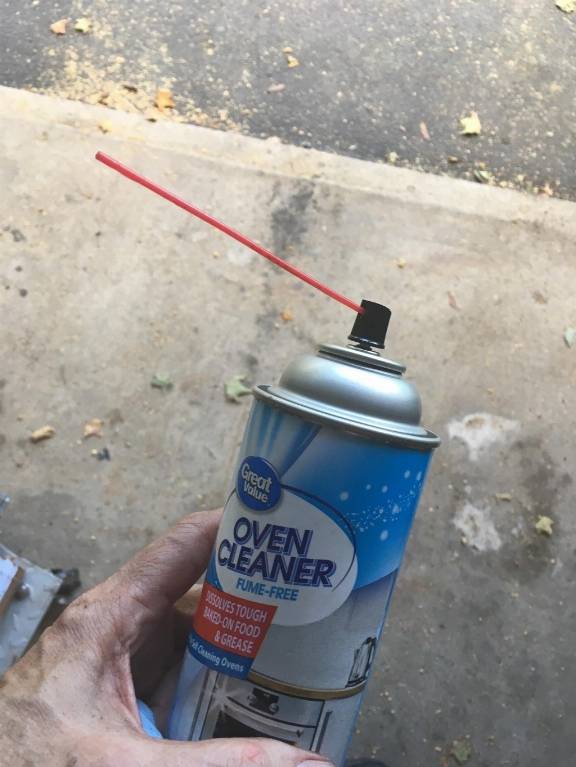

In the ongoing axle project, I decided that given a little bit of junk I found in the housing, that I would clean it out. My "go to" products are brake cleaner, cheap oven spray and a pressure washer. The oven spray works well for nasty oil stained parts, so I figured it would work well with this. Problem is with the oven cleaner, it comes out in a fan spray and I couldn't get it to spray down the axle tubes. I was tossing an empty can of CRC brake spray in the trash and the idea hit me to swap the nozzle with the tube onto the oven cleaner. This worked even better than I hoped and I could direct the spray all the way down the axle tube easily.
CRC and whoever makes the oven cleaner for Walmart use the same spray can! I wouldn't be surprised if they came out of the same factory.

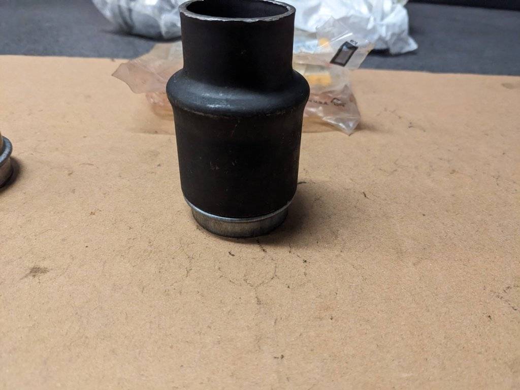

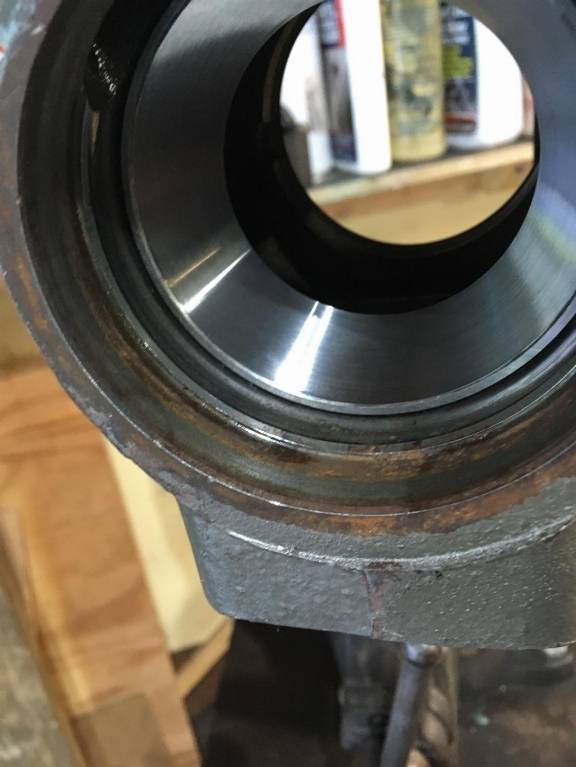

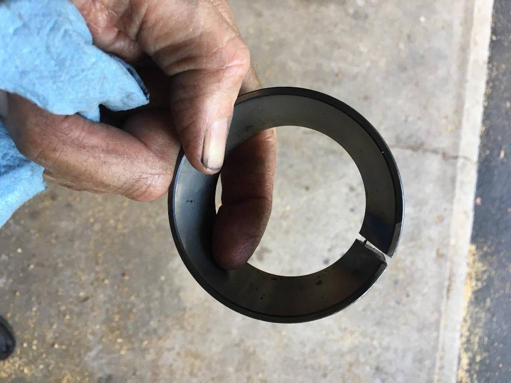

This was something I read while checking on what I needed to do to change the pinion bearings in my 8 3/4 center section. The front bearing race comes out easy enough, there's a couple notches to get a punch into. Putting the new race in was a little more problematic. I didn't have a socket or anything I could use to push the race down the bore. I read that by cutting a slit in the old race, it would fit down into the bore and push the new one in, and then be able to get it out easily. I cut the slit with my angle grinder with a cut off disc.
It worked great... A piece of steel across the new race (I should have taken pics) until it's flush with the end of the housing, then put the old race in place with the steel across it. When done, I just knocked the old one out really easy.

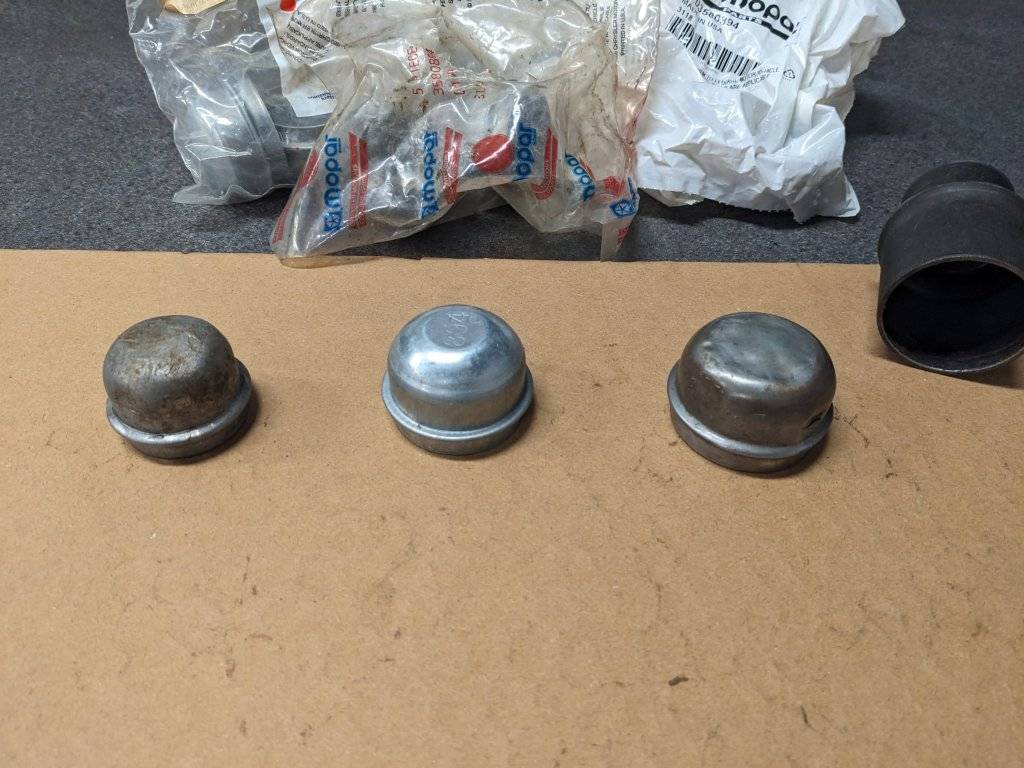

The bore with a new race.
The old race with a slot cut in it.

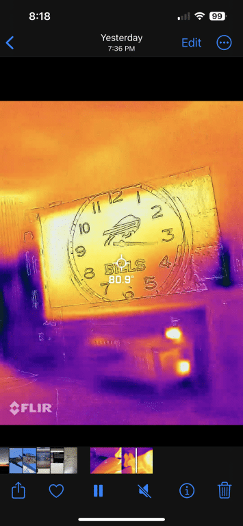

I just received this FLIR camera that works with iPhones or Android models.
FLIR One Pro LT iOS Pro-Grade Thermal Camera for Smartphones https://a.co/d/1DzmDNS
I snapped a couple of pictures with it while watching the Chefs game last night.
I will be using it for cooling system diagnostic purposes as well as just curiosity.
