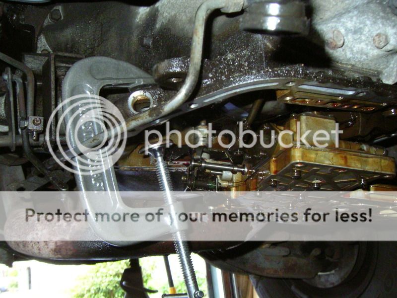

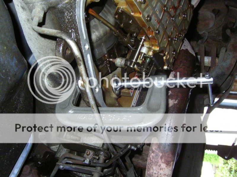

I've done this seal a few times. I just pull the pan, loosen the valve body, swing all the rods and shifter mechanisms down and around. The use a big flat screw driver and a small hammer to punch the old seal up and out. The use a big C-clamp and a couple flat washers to press the new seal down and into place.
Couple pics...
Thanks Brian, please see my next post. Fixed 2 problems. Created yet another. Tranny detent ball/ spring now back in place. Shifts great however car does not move in any gear. Im leaning towards the detent linkage? heading back to back of tranny as I removed entire assembly to fix ball/spring. I think maybe I reinstalled that incorrectly however it only seemed to fit 1 way.I had to wiggle it around quite a bit for it to find its spot.Please advise if you think I reinstalled that part correctly or incorrectly.Or if you think it could be something else.Appreciate all the great advice from all of you.
