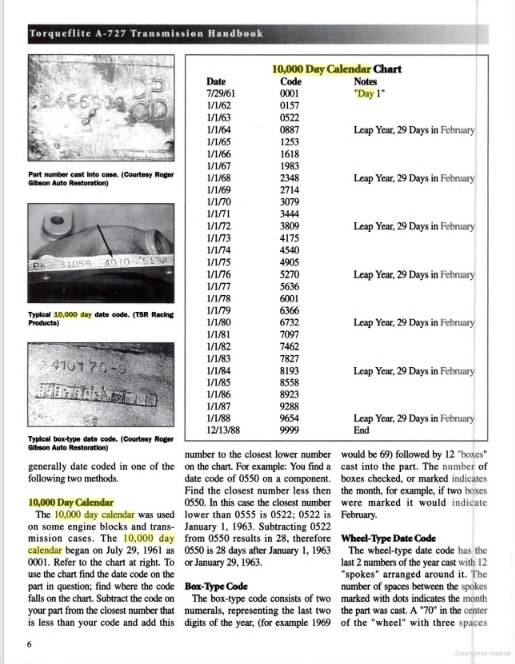

One of the better references I found was this page from the 727 Handbook.
I’m talking about when they started stamping the 10,000 day calendar dates on the trans cases.
I'm not familiar with that, but it makes sense. I do know they changed the style of how they stamped (or cast) the date codes over the years. Some got a "wheel" and some got a "bar" and some were stamped.
I thought it was more about supplier or what the component was.
I'm not into date codes that much, so I'll take your word on that... I'm going to try to read up on it though.
