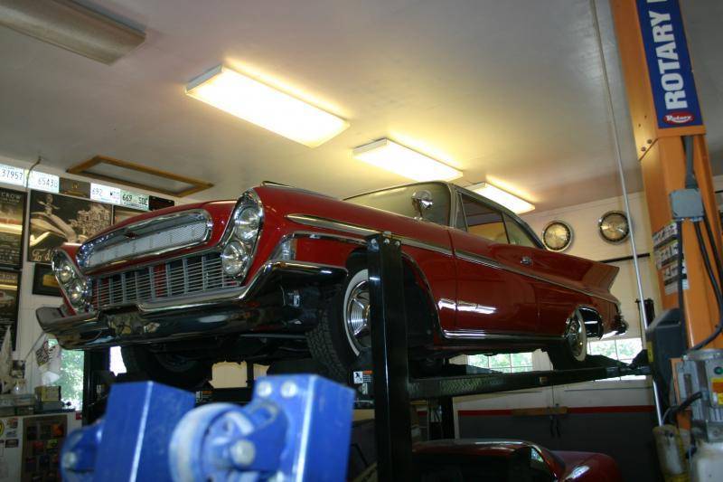

I have been working on a '69 Ply Fury III convertible and you folks have been of much help on that work. This is a question about another Chrysler product, a 1961 Desoto 2 door hardtop. !961 was the last year for Desoto production and this car is one of about 900 2drht's produced before production ended. It is very nice. Has been in the same family since purchased new back in 1960. We completely rebuilt it, engine, rear end, transmission, body, interior, everything. The problem is this: the transmission leaks. Not all the time but once it starts it really pours out. Seems to be coming from the front of the trans maybe from the torque converter. For example, it has been on this lift for 4 weeks as we watched to see when the leak would start. For 30 days, it did not leak a drop. Then it really poured out, probably a 1/4 or 1/3 IMG_6579.jpg quart in just a week or so.
We plan to pull the trans and put a new seal in the front. I just wondered if any of you folks had seen something like this before? Leaks none for a period of time and then just pours out! Any thoughts/experiences welcome. The car is not operated much so there will continue to be times that it is not operated. This problem must be fixed.

Yes, I'm inclined to vote for the front pump seal. But you might also want to have a good look at the drive sleeve itself. Check for pitting, scoring and just general wear.

Far as the trans leak, confirm there is NO leakage when the car is parked for a few days. This will help eliminate the shift shaft seal as the culprit. You could have a front pump seal going, as stated before; or the base of the dipstick tube may not be fully/properly seated.
