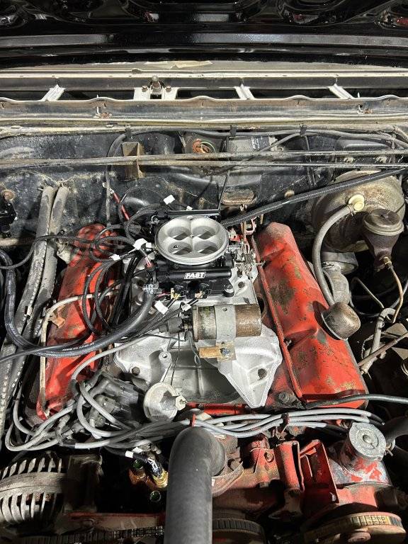

Hi i am having problème figuring out wich bracket to use for my ez fast injection kit does anybody can show me there set up câble for the kick down and gas câble please
Here is one of theirs on a Gen2 Hemi single 4bbl..

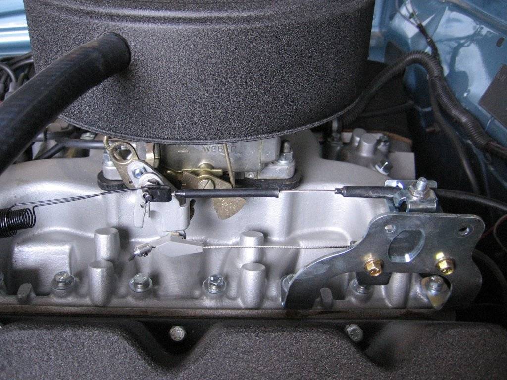

Yes. In the photo (Edelbrock carb with Edelbrock adapter)
I had to trim the base of the adapter because of interference with the kick down cable attachment point during full throttle.
After cutting off the interference point I painted it silver. They come anodized gold.
