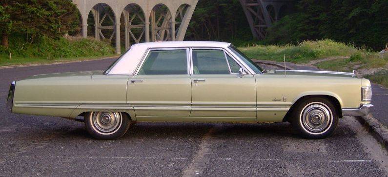

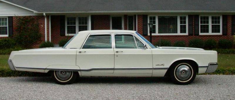

I justl ooked up a couple of pics regarding that and found this, you will see that what you are saying does appear to be correct, the bottom edge of the front fender is longer on the Imperial, cool. i have learned something!

It would have been nice if they had extended the rear of the chassis, but I suppose that would have required different tooling for the unibody, whereas extending the front requires a K-member and fenders, which are probably going to be a little different anyway.
Interesting also how much higher the front bumper sits on the Imperial. I wouldn't have guessed that.

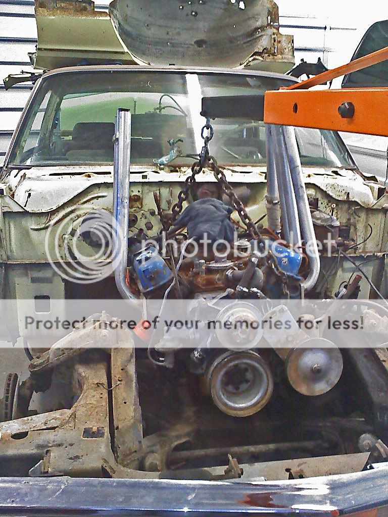

The imperial stub looks absolutely nothing like a slab C stub frame. The imperial is more like a massive stub with a K member bolted into it. And it will not bolt into a C body. The four body mounts will not line up. If you line up the two at the firewall, the ones near the trans crossmember won't go....and vice versa, because the imperial stub is longer.
Here is a shot showing the frame rail. I used to have a ton of stub photos and even one comparing a 65-73 c body to a stub imperial (67-73). I will see if I can find it. Just saying, even if the engine is in the right place, not sure if the TTI headers are bent to clear everything on an imperial stub.

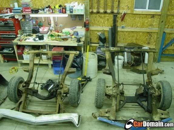

Here is the picture I was looking for. You can see where the firewall mounts verses transmission mount area is longer on the imperial (the right side stub in the photo). Hard to tell if the engine is set back farther into the stub than the c body, but it does look like it is.
Interesting someone would have two stubs side by side
I don't know where the photo originated, especially since it has a logo on the bottom. But I do know that jerking a C body stub and replacing it with an Imperial stub is common place in the derby world. Perhaps that it was someone doing a swap for that reason? Not sure, but I do know that the first time I seen it was on a derby forum, but it was not the posters own photo either.
Where is it from? And what's intriguing? Spill the beans, you have me curious.
Cardomain.com... the photographer may be had there.
Because who has two stubs like that? A guy who knows and is sharing knowledge.... i'd like to meet the guy with a C frame and an imperial frame in his garage
Ah....I just assumed a derby guy took the picture. You are right, after seeing what car domain was, it could be interesting that someone had both in their shop.
